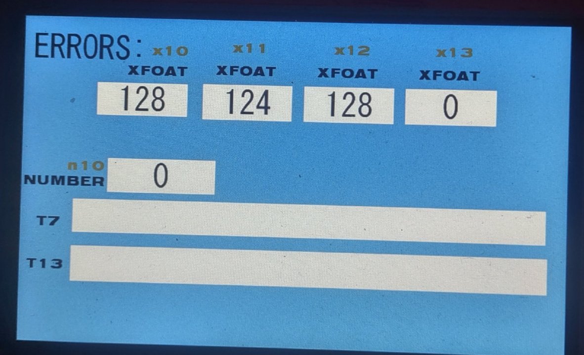

In this only option, it displays on the screen and after a few seconds the values ​​​​hang on the screen, but at the same time the diode (port B7) on the board blinks synchronously with the diode on the rs485 transceiver

Re: Protocol j1587
Post by mnfisher »
Regarding the row of two byte PIDs, for example: engine speed - PID 190, data 087 009 - PID_data[0] /; 087;/ + (PID_data[1] /;009;/<<8) I get a 16-bit value and multiply it by 0.25 (res/bit)
So - the PID - get from PID[0] - if this is >= 128 then the 16 bit value is PID_Data[0] (NOT PID_Data[0] + PID_Data[1]) As mentioned - the value might have the MSB and LSB swapped. If PID[n] <= 127 then PID_Data[n] = 8 bit value (padded to 16 bits with 0 in MSB)
The PID PID[1] has it's value in PID_Data[1]
There should be PID[n] and PID_Data[n] where n = 0..ISR_POS
However - it does sound like it is then crashing - see notes above about error checking - I'll add a couple of checks - max message size is trickier - but where "ISR_Pos = ISR_Pos+1" -> change to ISR_Pos = (ISR_Pos + 1) % 10 (Two places in the ISR) It might just be the reset needs a tweak too?
Can you step through in simulation using some of the data from above.
