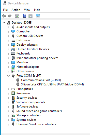

Under Device Manager I see my USB adaper under Ports.
I assume you have something similar.

Re: PIC18F25K22 UART ERROR
yes, my adapter is in devices ( my OS is Win10 ) as FT232R USB UART , and working well at COM6...Maybe there is a problem with Office, so I'll try to test with another version , hoping to solve that..otherwise we'll have more work...

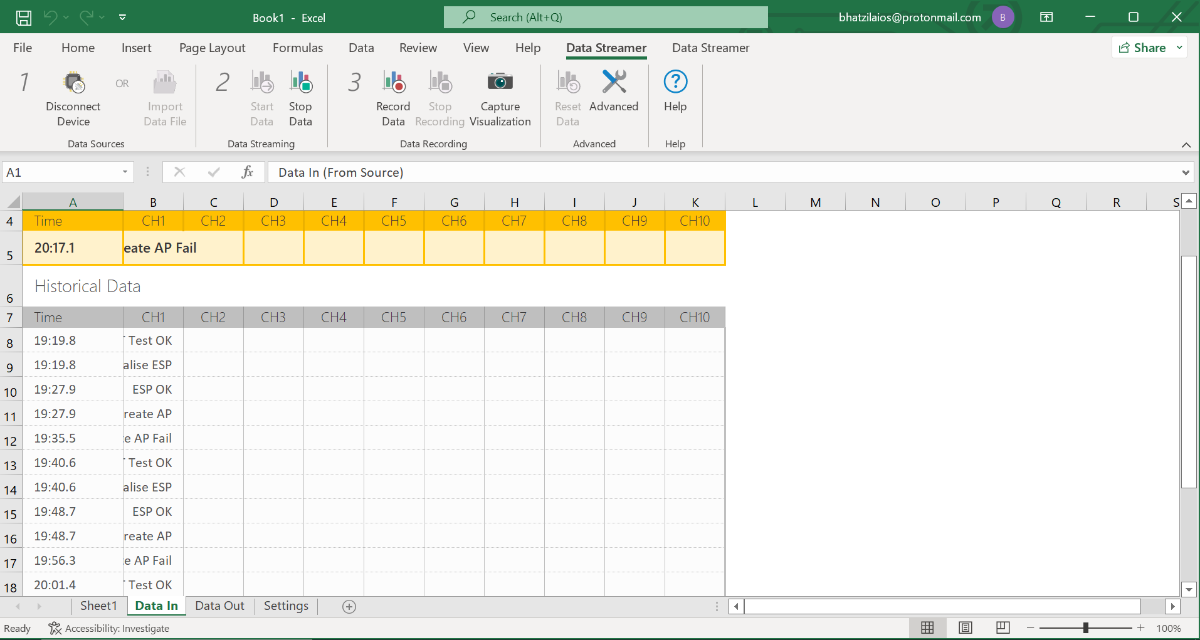

now I use Office 2021 ... DS it seems to work...I get diagnostics info in DS , but no data...
in Teminal I have info and data ...in DS I get "CREATE AP FAIL "...something wrong in boot procedure? I do the same for
Terminal and DS...
Terminal and DS...
If you expend the second column you will see the full message, but it is telling you it has failed to create the AP
It tells us it is initialising OK but that just means that it has issued the command and has moved on.
There is a bug in the command in that it looks for a reply of "Connect" to signify everything worked, but the ESP now replies with "OK". Maybe Matrix will fix this sometime?
The program assumes all is good until the next step.
It then fails to create the AP which is just a simple command.
My bet is that the ESP isn't connected or powered. Perhaps Tx / Rx reversed or the like?
I was checked again connections...I can't see something wrong...
looking at receiver chart, at macro ESP_Setup, in Create AP there is different Ret in same decision for Terminal and DS.. In Terminal program Ret is 1 , so diagnostics chart execute until Waiting For Data.....in connection with DS , it seems Ret=0 , so execute "no" branch of decision ---> create AP Fail ---> UART RESET...
I don't understand why this happens in DS..It seems to me something wrong with DS maybe some setting or timing, not with FC command..
in the tests some time I saw AP created in DS input data, and in the next loop Create AP Fail..
It will help if you can test only RX chart with an ESP/PIC18F with 2 Uarts to obtain diagnostics , and check Create AP.
