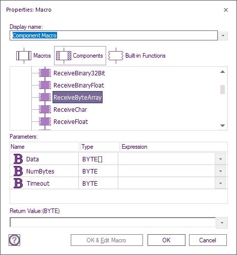

If the macro parameter has an array of bytes or ints etc then this is passed by ref and so you can basically pass blocks of data in or out of a DLL by using this method. A return string basically does the same thing but probably should be avoided as any 0's in the data would potentially be seen as a null termination.
If you see the UART/COMPort component Send and Receive Array functions then this should give you the idea.
Another way without using arrays would be to store the data inside the DLL and then have a macro to pull out the data a single value at a time. You might have a getCount macro which checks for stored data and a getData macro which gets the next data value.
