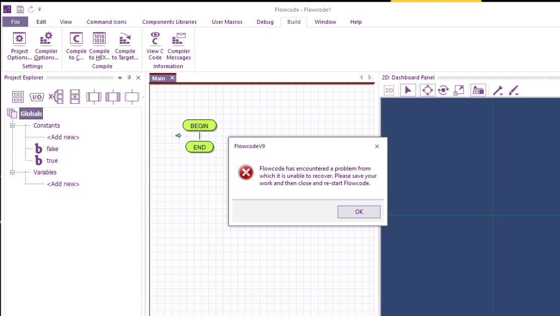

When I start an empty project and if I click on "build", Flowcode display this error message: "Flowcode has encountered a problem from which is unable to recover. Please save your work and then close and re-start Flowcode":
Clipboard 3.jpg (79.5 KiB) Viewed 3657 times
I Uninstall / Re-install flowcode with no change. Tried to start it as administrator with no change.

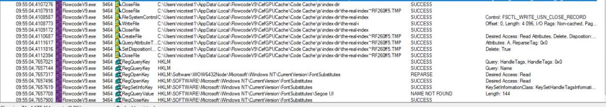

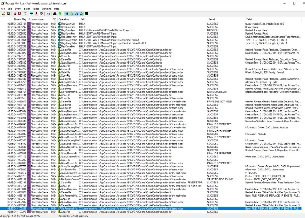

If it could help you, I used "ProcessMonitor" to find what happens when I click on "Build":
Clipboard 2.jpg (88.73 KiB) Viewed 3657 times
I checked that the current user has write privileges into the directory "appdata", OK.
This happens on some computers only, others works normally...
