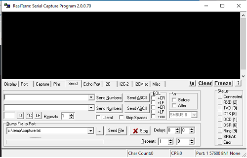

Posts: 2424
Has thanked: 778 times
Been thanked: 839 times
Re: Escape Characters
There is also Realterm that has the following sending options:
