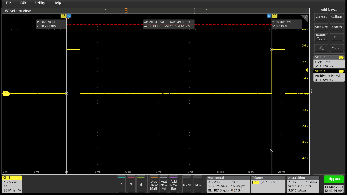

Post by dvcam99 »
Hi Ben,
many thanks for the super fast fix!! Works great. :D
Scope shot below:
Additional question!! Is there a way to edit the frame rate. Now it is fixed at 20ms (50Hz). Cool would be 15ms and 10ms (75Hz and 100Hz) too.
BR
Dirk
Happy FC9, FC-8 and FC-6 professional user ;)
Posts: 2334
Has thanked: 647 times
Been thanked: 856 times
Re: ESP32 and servo controller/ ninja failed with exit code 1
Hi Dirk,
Brilliant glad it's working for you the servo controller component is currently fixed to 50hz but the pwm component should allow you to easily do this.
