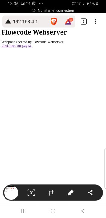

I exported your macro "Initialise_WIFI" then imported it into my program I also added a circular buffer and web server and copied your setting but I cant seem to be able to get this to work I can connect to the network but there is no fields to fill in so I'm not sure what I'm doing wrong? It seems to be pointing to a different web page.
This is what i am getting back on the UART not sure if it will be of any help, must be something so small that I'm missing as if i compile your to example "ESP32_Config_Wifi" everything works. Also I'm not sure but I'm using modbus as well and a number of other components but I first go call the Initialise_Wifi Macro and that's where i sit so nothing else is initialised except the UART for testing purposes.

I found the issue I never filled in the HTML Code it all seems to be working
<html>
Flowcode ESP32 Demo - Network Config Page
<form action="submit.htm">
<label for="0">SSID</label>
<input type="text" placeholder="Enter SSID" name="0" required><br />
<label for="1"><b>Password</b></label>
<input type="password" placeholder="Enter Password" name="1" required><br />
<button type="submit" class="registerbtn">Register</button>
</form>
</html>
