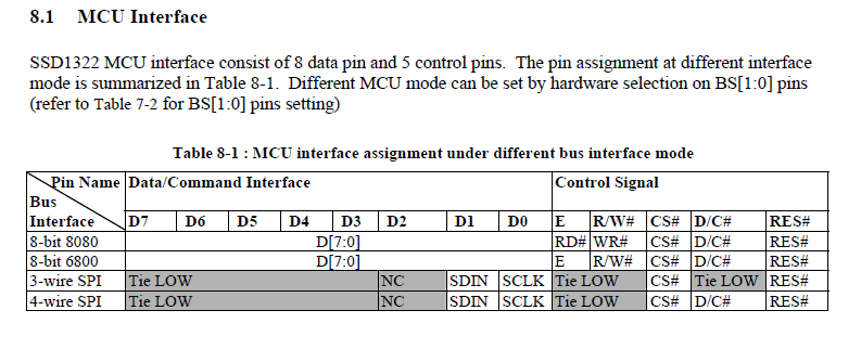

I have configured the display pcb for 3 wire spi. connecting the d/c pin low as per the attached datasheet image.

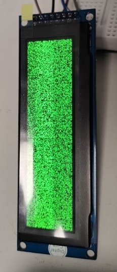

I have written a test program from scratch also attached which works on the simulator but when I download it to the bl0080 all I get on the display is a speckled pattern shown in attached photo.
when compiling, the following warnings appeared which I don't know what they are and whether they are causing the issue
TEST3.c: 2743: (764) mismatched comparison (warning)
TEST3.c: 2743: (757) constant conditional branch (warning)
I might try and create a custom part by copying the existing one and editing it to be similar to ssd1306

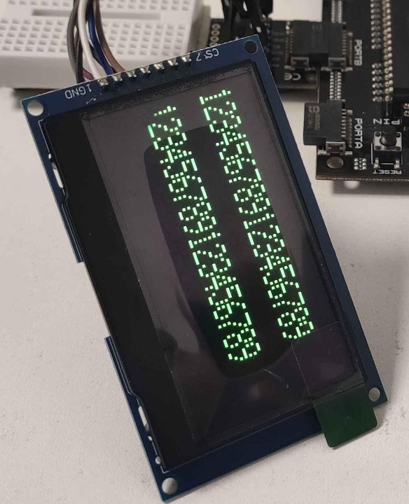

Just tried it using the ssd1309. attached photo shows it worked, code is also attached, no compile warnings

Great glad it's working but it looks to me like it's skipping over every other horizontal line.
This could be a difference between the 1322 and the 1309. I'll have another look at the component and see if I can purchase a 1322 display so we can get this properly sorted for you.
edit: there not cheap are they! I've bought one that can be configured for parrallel and also 3/4 wire SPI so hopefully that will allow me to get both components up and running correctly. Should be here in a couple of weeks.
