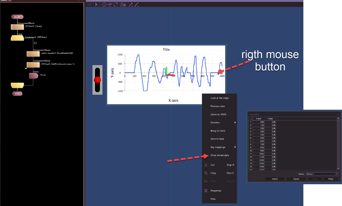

I made you a small App as a demo how easy it is to draw a chart with FC9 and save the data in excel.
Load the program and press F5.... then move the joystick at the end right click in the chart
A question about the MMA8452. How would you like to use it? As motion tracking or orientation change, or tap,
About the FSR would you like to use it as tap for switch or more like personal scale?

- JoyStick_Chart.fcsx
- (15.3 KiB) Downloaded 916 times
