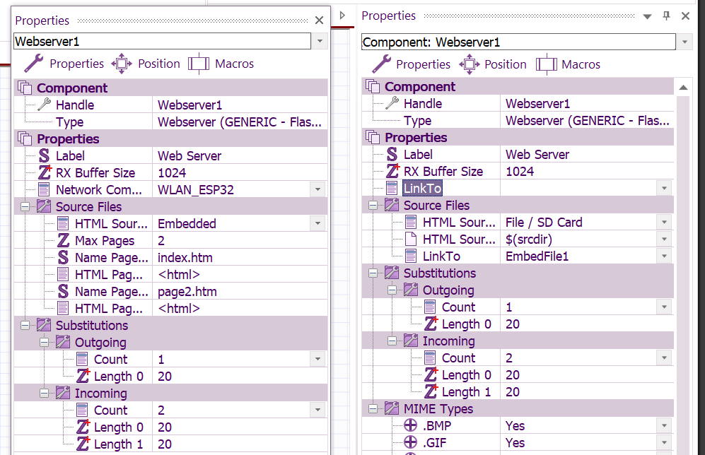

Not sure if this is a bug or my misunderstanding?
On the esp32 - trying to use a WebServer component. I have wlan_esp32 and NetworkComms component added. There is a 'link to' field in properties - in v9 this would link to the network comms component. In v10 I can't select anything (so incorrect component added?) and there is no tooltip to suggest what I should be looking for?
v9 is left and v10 on the right - field in 'properties'. Any pointers here?
Posts: 2061
Has thanked: 311 times
Been thanked: 479 times
Re: Bugs in initial v10 release
Martin - I believe that is one of @BenR's components and so I'll let him answer that one.
