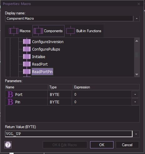

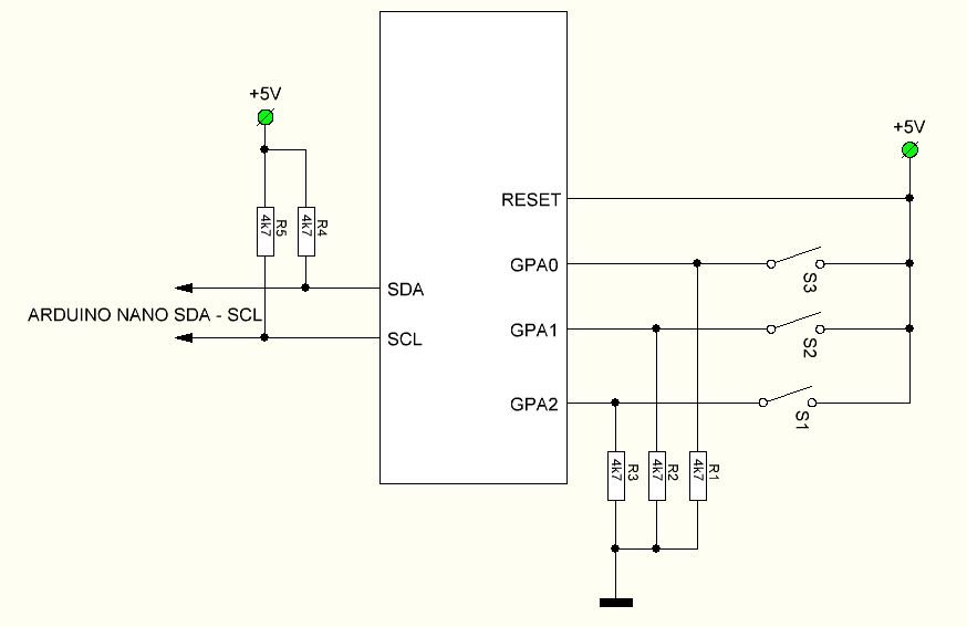

I use Flowcode v9. The output already works with the MCP23017, but the input does not. I want to use only certain inputs from the MCP ic, with a push button. If I press the button, the value of the corresponding variable should be 0 or 1. This is what I want to achieve.
I have attached pictures.

Does reading the port work?

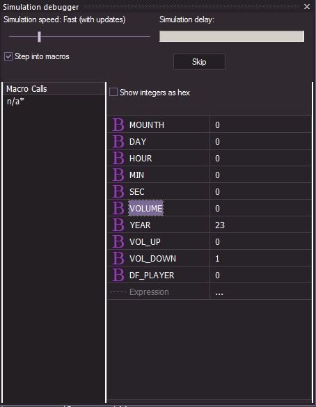

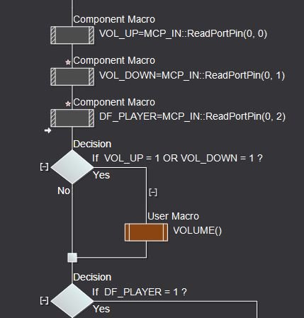

Only "DF_PLAYER" works, "VOL_UP" and "VOL_DOWN" do not work. Also, the value of "VOL_DOWN" is constantly 1. (no button is pressed, the value of "VOL_DOWN" is still 1.) It does not respond to "VOL_UP".

One thing I have noticed.
With you have got OR which is a bitwise OR operator.
Can you try with || which is a logical OR operator.
| is the pipe key which is usually on the same key as the backslash \
Have you measured the voltage directly on the MCP23017 input pins to check the hardware?
With
VOL_UP = 1 OR VOL_DOWN = 1Can you try with
VOL_UP = 1 || VOL_DOWN = 1| is the pipe key which is usually on the same key as the backslash \
