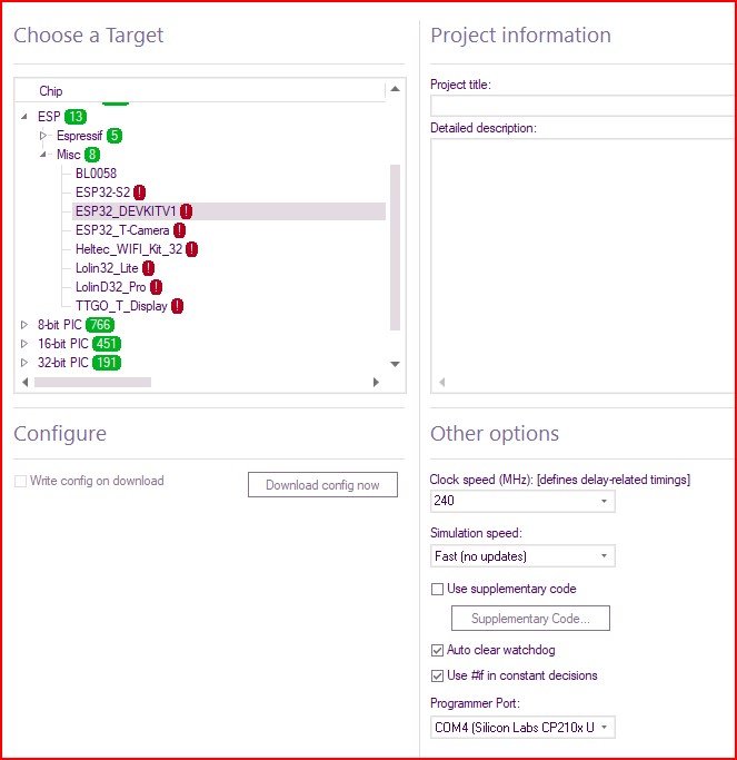

Hello everyone
User: Flowcosev10
Where in Flowcode V10 can I set Port to Port = 4
Choose a Target.jpg (53.37 KiB) Viewed 6011 times
I can't transfer flowcode 10 codes this way?
Or do you have a suggestion :D
Best regards
Monie

Hi Monie,
Bottom right of your screenshot shows the COM port. Is this what you're after?
Are you getting any errors?

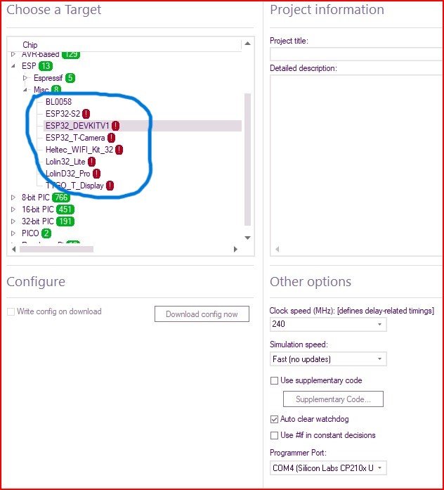

Even given that I have a Flowcodev10 Pro licens
I have a ESP32_DEVKIT_V1 and when I try to compile it secns to do so.
But notning get send to the ESP.
The Program is not changed.
If I use Arduino IDE with Com 4 it works.
I seem that the ESP_DEVKIT_V1
Is not reconicecl by Flowcode v10

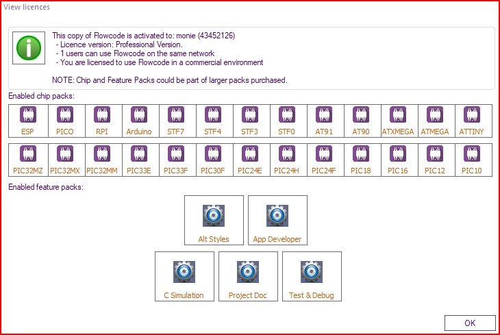

The 'You do not have a valid licence to perform this action'
Would either suggest you have not purchased the ESP chip pack, there is an issue with our database or you have not refreshed your licence since purchasing any chip packs.
I have refreshed your licence as well, as I can see you do have the licence for the ESP chip pack
Can you please run Flowcode and select Licensing > Manage > My Flowcode Licence and re-enter your account details.
If you already have a project open then it's Via Help > Licensing>Manage>My Flowcode Licence.
You will need to restart flowcode after entering your accound details.
You can tell if the chip packs are enabled by going to Help > Licensing > View all enabled chip packs should have a purple background.
If they have a red background then they are not enabed via your licence.
Can you let us know how you get on, please?

Have you done:
If not, please do this.
monie
Posts: 73
Joined: Wed Oct 19, 2022 4:06 pm
Has thanked: 1 time
Re: Flowcosev10
Post by monie »
HI kersing
Sorry i misunderstood the update first.
License update worked.
Now all i purple ;)

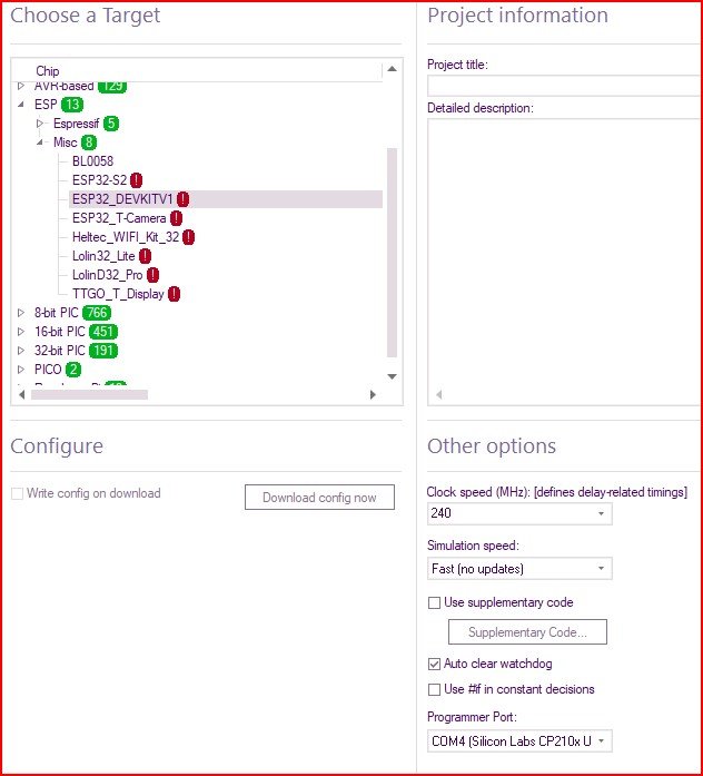

i restarted Flowcode and tried to build a simple Blink project, then it said Python needed to be updated and i used ESP-IDF install.bat for that and now the compiler can run a Build but still it seems that the ESP32 Devkit V1 I have is unlicensed.
Choose a Target.jpg (53.73 KiB) Viewed 5898 times
I can chose it and the project say it is sending data to it if i try build a simple Blink loop.
I have checked the ESP again with Arduino IDE ad i can send the Blink.INO to the ESP and it works.
I get the attached compiler message

The messages say the code compiled and uploaded to your device correctly. Is your flowchart using the right pins on the hardware?
