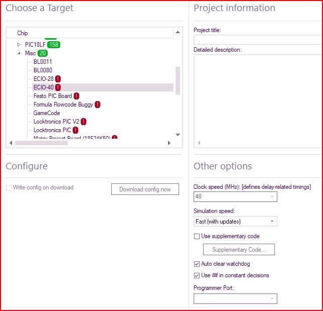

Hello everyone
User Flowcode V10
I am trying to connect with ECIO 40P but without success.
See the picture below!
Do you have a solution so I can use the device ECIO40P
See attached file:

The red exclamation mark means that you need to purchase the associated chip pack to use the target, however I understand that even if purchased it may still show red (bug) but will work.
You say you are trying to connect (so I assume you can compile without issue) but you have not specified a Programmer Port in options above. Once you install any necessary drivers an associated Com Port will be available under Programmer Port. Select it and you should be good.

Re: ECIO40P
Hi Monie
This issue has been fixed in the latest update that has not been released to the public yet.
I have spotted there is a bug with the lcd_I2C Clear component macro that is stopping I2C from working.
Can you delete or disable it and try again, please?
We will investigate the bug as soon as we can.
This is true in your case as I can confirm you do have the licence required to compile with your selected target device.chipfryer27 wrote: ↑Sat May 20, 2023 11:01 amhowever, I understand that even if purchased it may still show red (bug) but will work.
