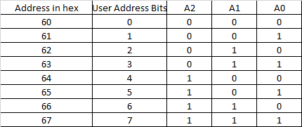

Following on from Ben's post about the address.
You might already know this, but if so this will be useful for other people with a similar device.
The User Address Bits is of course determined by the Logic state of Pins A0 to A2.
If I was you I would the voltage of the pins and then set the User Address Bits according to the table below:
MCP47x6 DAC I2C Address.png (6.75 KiB) Viewed 9090 times
If you are still having issues, then I will order a DAC and see if I can work out what the issue is.
The Address in Hex column is just in case you are using a logic analyser that shows address.
If not it can be ignored as it's not required for your project file.
