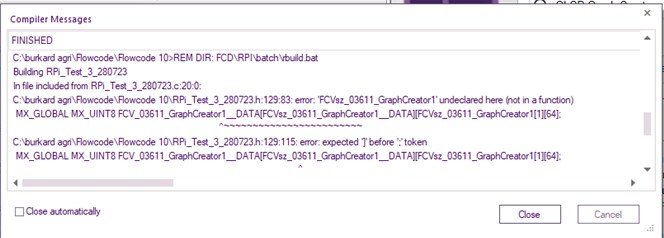

i am trying to use Component: GLCD Graph Creator and Component: GLCD XYGraph Creator. so far all i get is compiler errors. there is little or no information on how to use this function. there are no examples to check.

under the User Macro XYgraphcreator i have tried both avaiable graph creators. i have under Creat_Graph have drawn the graph long hand. it would be possibly be easer to use the built in graph creator, if we find out how to use it?

- flowcode error.jpg (29.62 KiB) Viewed 3175 times

I have updated the component library in flow code. I have deleted all references to previous versions of the graph creator. I have imported from the library new graph creator component. I still get the same error on compile. am I using them incorrectly?
I have attached current version and the error screen is the same as before.

It's compiling ok for me, did you run the Help -> Library updates?

i have run the Help->Library updates. I downloaded all updates and restarted flowcode. It now shows no updates available.
