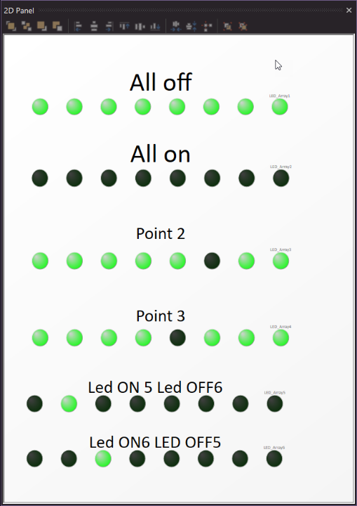

Hi Steve
on and off are somehow interchanged and also to set a led on/off is not correct.
App Developer Led Array on/off reversed

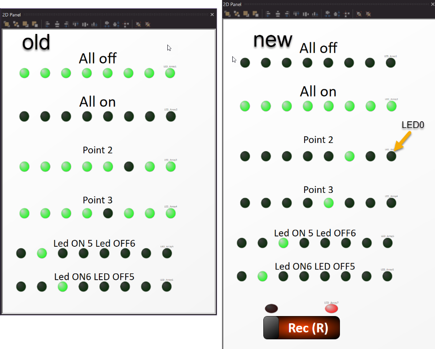

Hi Martin
Perfect! Yes it's working nice.
Also test the Bargraph and WriteValue, and this works nice.
ols vs new
ols vs new
