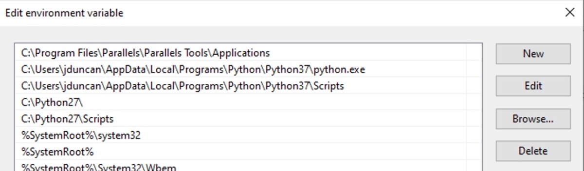

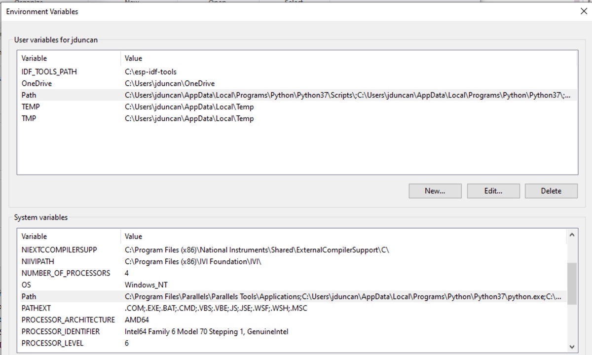

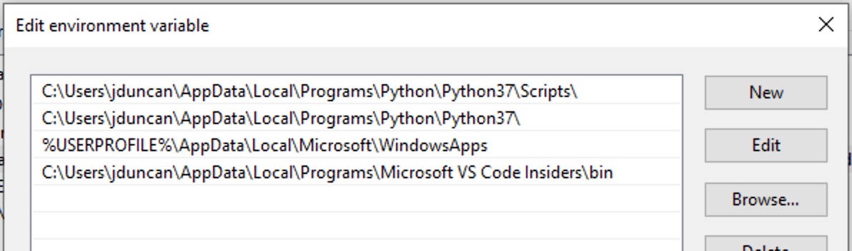

Thanks for the response. Your suggestion solved the problem, although there was an intermediate step which I'll document here in case it might help someone else.
The various installers had done their job, but had left the path pointing to "\Python 3.7\Python.exe" instead of just the folder "\Python 3.7". This caused the compiling process to use Python 2.7 instead of Python 3.7.
Here are the screen shots of what did NOT work correctly:
Screen Shot 2023-08-21 at 12.14.36 PM.jpg (159.05 KiB) Viewed 3540 times
Screen Shot 2023-08-21 at 12.15.04 PM.jpg (102.51 KiB) Viewed 3540 times
Screen Shot 2023-08-21 at 12.15.53 PM.jpg (97.29 KiB) Viewed 3540 times
That setup caused the esp32 compiler to access Python 2.7:

The fix was to change the environment variable from "\Python 3.7\Python.exe" to just the folder "\Python 3.7".
Thanks for the assistance...
