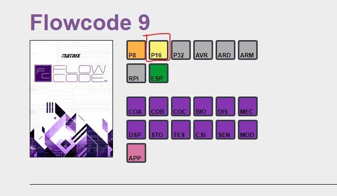

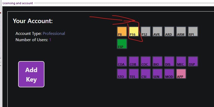

hi,
I have contacted Alfie Dobson and now I have the licence PIC16 toolchain
See web picture
Flowcode account website.jpg (33.23 KiB) Viewed 12019 times

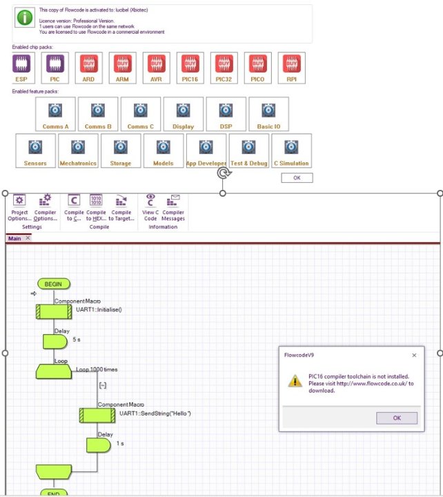

see picture from FC9
Flowcode .jpg (32.56 KiB) Viewed 12019 times

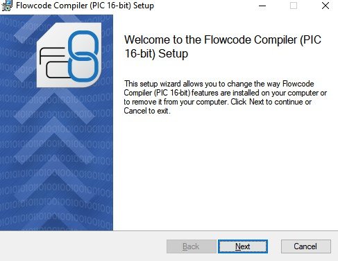

but when I'm installing it's always install it on FC8 !
Compil .jpg (32.46 KiB) Viewed 12019 times

so I have:
1- uninstalled the PIC16 toolchain
2- restarted the computer
3- start flowcode as you can see the PIC16 is disabled
try to compile to see the error message : PIC16 compiler toolchain is not installed

Install PIC16 toolchain
installation is showing FC8. may be not a problem because compiler seems to be same for FC9 and FC8.

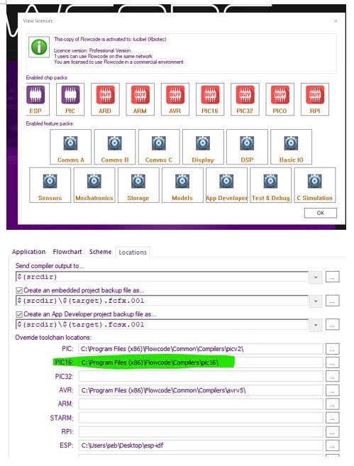

5 - restart the computer
Start FC9
PIC16 still not activated.
Try to compile. Error message is now : You don't have valid licence to perform this action
PIC16 toolchain installed.jpg (64.87 KiB) Viewed 11994 times
