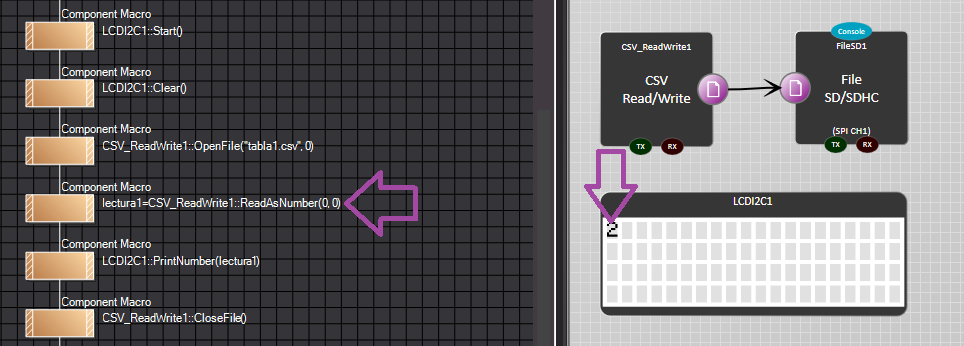

Hello everyone.
I started using the Component:
CSV Read/Write
using the macro:
ReadAsNumber

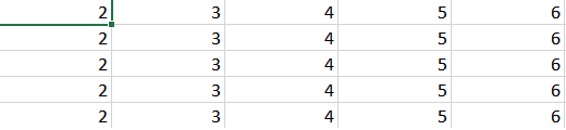

using csv file:

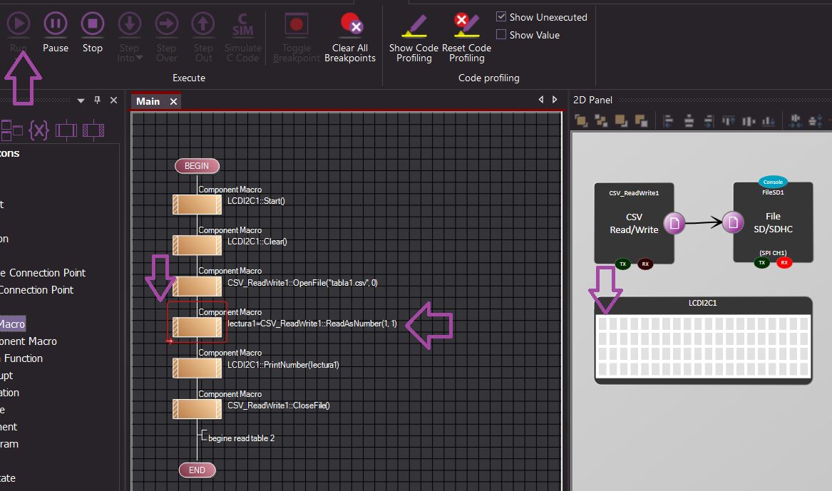

when I try to read the cell with the position row: 1 column:1.
It never works to read a position other than row:0 column:0.
The simulation never ends and does not display any value on the display.
assuming that if the value for row:0 column:0 was obtained, the connections and components are correct.

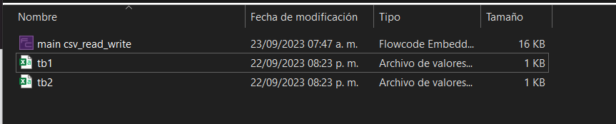

main csvr ead/write.fcfx file
2 diferent csv files to test
main csv_read_write.zip
(6.79 KiB) Downloaded 600 times
dont forget to change files folder root directory

Many thanks for letting us know, hopefully fixed for you now via the library updates.
