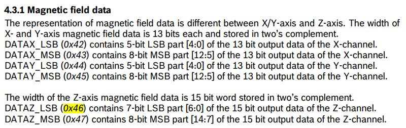

Can you have a look if at the component BMM150 if is a problem reading Z axis?

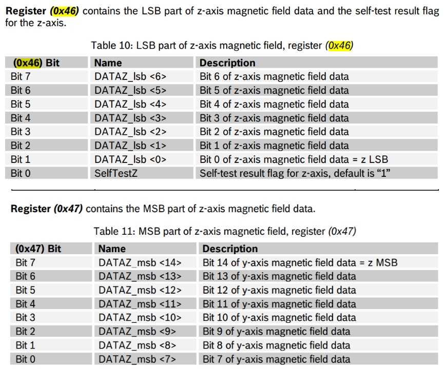

It could be that at the Z axis MSB and LSB are swapped or not correct.
Somehow for this component, the register for z axis are not built same way as for x axis and y axis

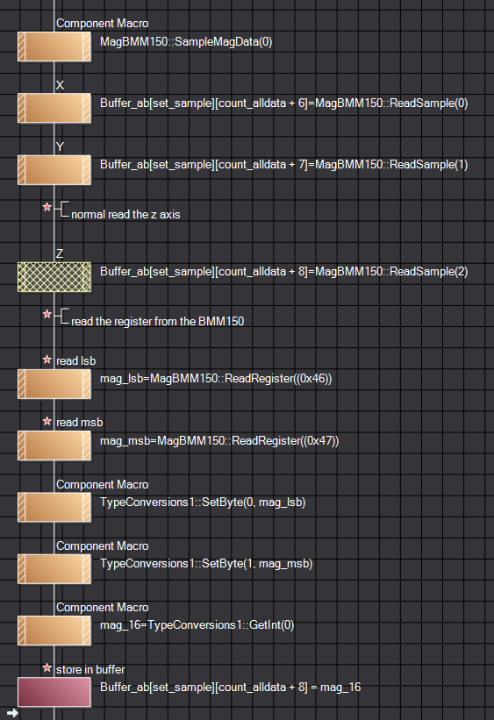

If I read the registers directly I get reasonable values.
read register
register are not the same:
for z

When I read the registers directly I get different values. I have tested these new values

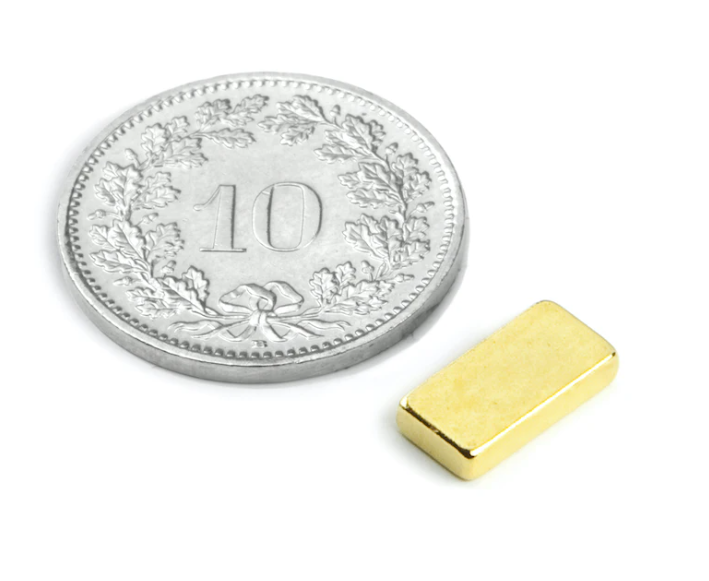

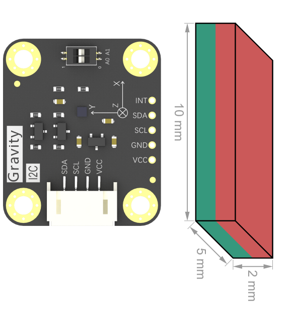

I used a magnet to test the XYZ axes and the readings seem to be ok.
small magnet

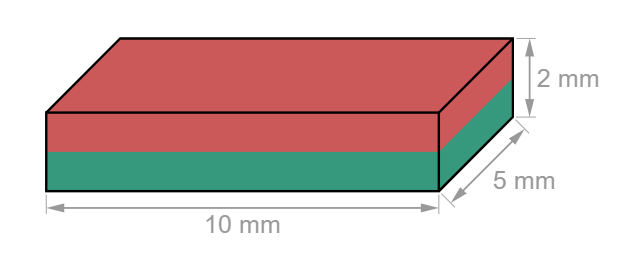

Magnet has two pol in this direction
I put the magnet on all the six side in the same way and read the values
