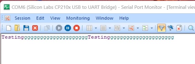

Just trying to make a simple Flow with stm32f030c8
>init urat -> receive string -> send back the string that was recived
I send Testing I receive : ggggggggggggg
Also is there a way to set uart parity to even ?
Using Flowcode V9

Hi again after experimenting a bit more
found that the bug is in the Uart interrupt, removing it and making the receiving string in a loop
works fine , but I wish to use the interrupt as the MCU will be doing something alse ,
also the interrupt will not work at all if the uart is in software mode .
Any help please

I think that the interrupt routine needs to just receive one character (ReceiveChar) - it can stuff this into an array or add it to a circular buffer. Currently it attempts to read the whole string.
I would suggest having the interrupt routine set a 'data_rcvd' flag on an end marker (EOL - \0 for \n for example) - then the main loop can process the string when it has been completely received.
It is difficult to receive a string in a main loop - if you are doing anything other - unless using an MCU that buffers the input (raspberry pi?) (the timing is impossible to get right!)

thanks for your reply , but no I have used the interrupt this way before to receive a string
with other chips and worked fine , there is a BUG in the interrupt 100% .
If this can't be fixed right away, maybe a good workaround would be a custom interrupt
on the falling edge of the Uart RX pin, but I don't know how to do that will also be needing
another one for Urat 2 as I will be using both Uarts

I have tried receiving 1 char at a time and then concatenate in a string but the interrupt is not working as it should .

No the problem is not in simulation , is when downloading to chip ( hardware ) .

It looks like it is just receiving the last character ('g') of 'Testing' - which means an interrupt is occurring. You don't add an end marker to the string (a '\0' - I'm not sure if ReadString does this) and although it is initialised to "" this just sets the first character to 0. It might be worth testing by setting the whole string RX_U1 ro 0s (for .i = 0 to 127 RX_U1[.i] = '\0') I suspect the ReadString is just reading the last character for some reason?
Please post your SingleChar version too...
