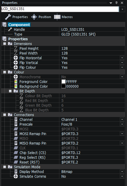

LCD_SSD1351 FC8 FC9 not compatible
LCD_SSD1351 is working FC8

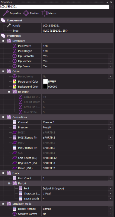

But FC9 not compatible with F8, how the text is on the display. Some text is turned 90 deegres and fonts are different
And the propertis looks new in FC9
Do you have some infos?

In the simulation the Text and the line turning around. In the hardware is just the line is turning, the text is always in the same direction.
