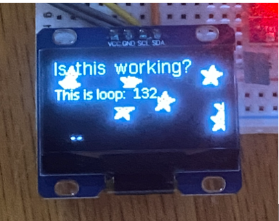

I just tried it again and it did start to write text, but the "ClearDisplay" does not work, so the last image from the Adafruit demo is still on the screen. I attached a picture of that as well.
I attached my program. It is pretty simple.

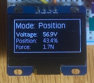

Update. I recreated the program from scratch. Now it runs, but "ClearDisplay" still does not work. I got around that by drawing a rectangle over the entire screen area and then writing my text values for the value labels. Then I have a loop where I update the sensor values.
My problem now is that the display updates are really slow. I am writing 3 values to the screen that each have a max of 3 characters and a decimal point. The update rate on the display is about 2.5Hz with nothing else happening and no delay timers. The simulation in Flowcode runs much faster than the actual screen. I am wondering it this is as good as it gets or if there is a setting that can make it faster. I have the i2c rate at 1 Mhz. I am wondering if there is another setting that is slowing it down or if this is as good as it gets.
I attached the diagram.

Re: OLED display issues, gLCD_SH1106_I2C1, Arduino Nano
Sounds like there may be a bug in the "ClearDisplay" macro.
Datasheet for the display suggests a maximum of 400KHz for i2c

Noted on the I2C rate, I tried that just because the updates are so slow. It didn't really improve the update rate.
Is 2.5 Hz the best I can expect for just displaying a few numbers? I really thought this display would be an improvement over a 16x2 character display, but not unless I can get it to update faster. Not sure where to look to make it faster.
Thank you for answering my questions,
