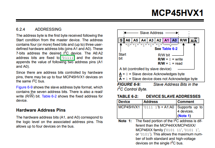

The datasheet for MCP45HVX1 shows:
MCP45HVX1 addressing.png (167.5 KiB) Viewed 10282 times
Therefore the fixed address should 0x3C and not 0x38
If the fixed address was 0x38 then it would be 01110 instead of 01111, unless the datasheet is wrong?
Anyway, I will try as per datasheet, and if that does not work I will change the address to 0x38 instead.
I have not got a digital pot to tst with, so can you let me know if it works or not please?
If it does the it will be added to the component database.

It must be address 38, as the original MCP45XX MCP46XX component has 1 more variable address, bit 3 with the value 4. 0x38 + 4 = 0x3C. I therefore always had to set address bit 3. Then the addressing was correct. Of course it was just a workaround and worked well. Now it is as it should be!
Many thanks for this.
Dirk
