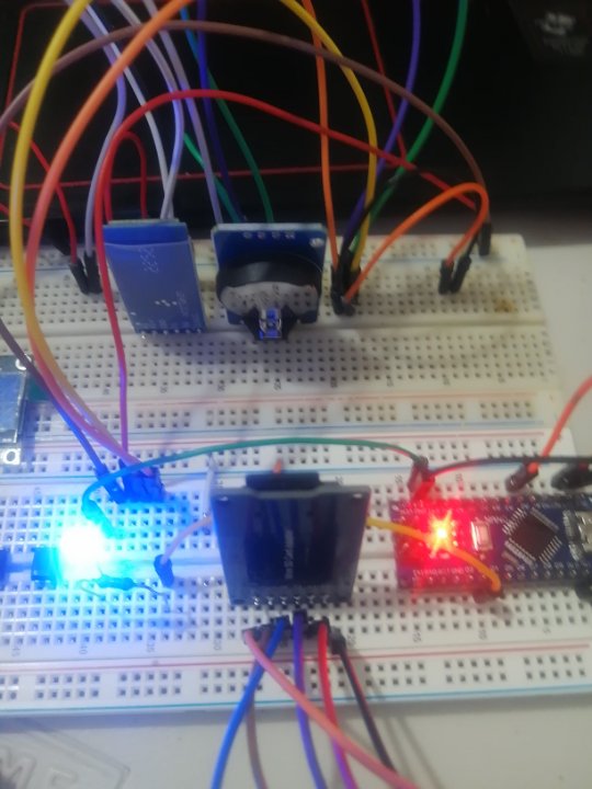

Macro file sd/sdhc bug
Post by Mcolin »

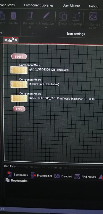

Component macro
filesd::initialise()
Don't step out on real hardware running.
Work flow
1.-Initialise screen
2 - initialise sd module
3- print: finish line code
Please check the complete hardware demo upload video:
https://youtu.be/gAGuB8S4pEk?si=rwANGc9KHbJED69H

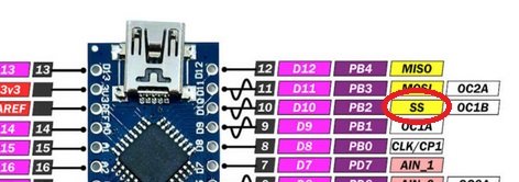

Are you using an AVR based micro by any chance? The hardware spi can lock up on these if the ss pin is left floating or allowed to go low. It will need to be set to an output or tied to VCC with a pull up. If you can use it as your CS pin then that should solve the problem. Its a feature of AVR hardware.

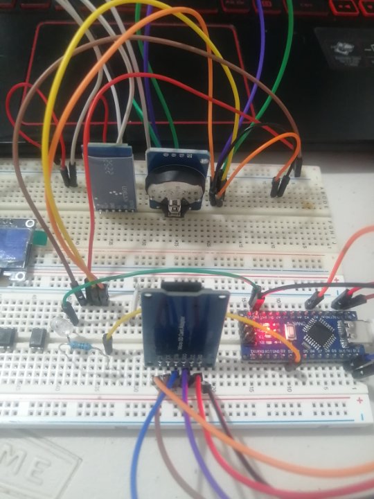

Spi cs/ss is working well and correctly conected

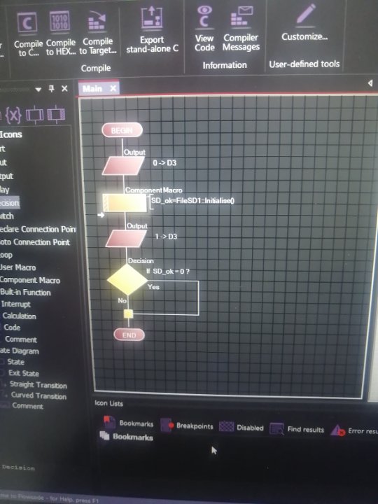

Initialise sd macro can't step out to continue the flow.
In the example:
1.- an output begins with 0
2.-then the component macro "sd initialise"
3.-and at the end output change to 1 to turn on a led
The led don't turn on, the initialise sd macro can't step out.

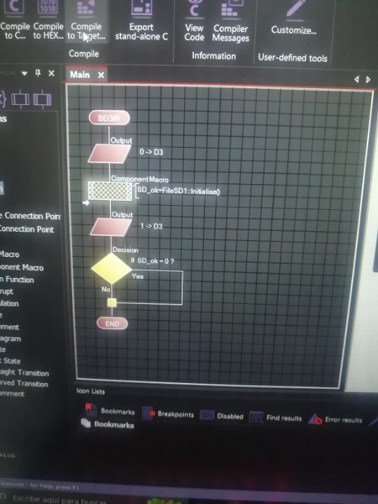

Mcolin
Posts: 11
Joined: Thu Aug 17, 2023 3:45 am
Re: Macro file sd/sdhc bug
Post by Mcolin »
If disable sd initialise macro
Led turns on so looks like sd macro initialise can't step out to work with sd module

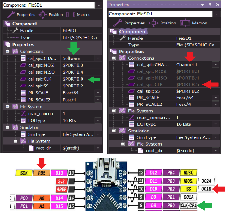

Posts: 2309
Has thanked: 642 times
Been thanked: 850 times
Please change the CS pin of the SD component to pin D10 / PORTB.2, this should solve the problem.
Please see my first post for an explaination.
Mcolin
Posts: 11
Post by Mcolin »
---> The CS pin of the SD component to pin D10 / PORTB.2 DON´T FIX THE PROBLEM
--> DEFAULT CLK PIN SETTINGS (CHANNEL 1) PORTB.5 DONT WORKS
THE PROBLEM WAS SOLVED IF:
CHANGE CLK PIN PORTB.5 ----> PORTB.0
