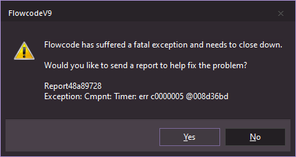

Using RadioButton revs 4 or 5 puts up an error.
"Flowcode has suffered a fatal exception"
If I select YES the program will Freeze.
If I select NO the program will close.
RadioButton rev 1,2,3 did not put up this type of error.

Thanks for letting us know, Hopefully this problem should be fixed for you now in the latest release.

Excellent. The fatal exception is gone. Thank you.

Small observation in Rev7:
When the radiobutton is first placed on the 2D Panel the button spacing is large.
After 18 seconds the space between the buttons will auto correct.
Properties for spacing is set to 1.500000 but for 18 seconds the spacing shows as if 48.00000.
There was a similar issue in Rev6 but the button spacing looked like it was set to ZERO.
Looks like you are already working on this issue.

We have fixed the problem properly in the upcoming release of Flowcode however for now we have solved the crash by adding the time delay to ensure the component is fully loaded before redrawing it. On most projects this equates to a delay of up to 20 seconds but this large delays buys us time when loading much larger projects.
Once the new version is released we can remove the time delay and the problem should resolve itself.
