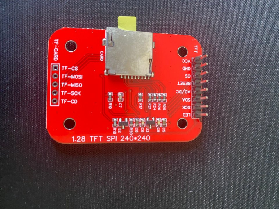

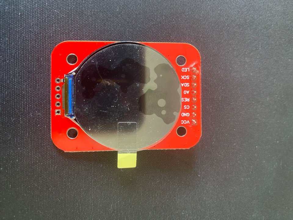

Hello Jorgen
Warm greetings to you and the entire Flowcode family from Istanbul.
First of all, thank you for your message. I bought this product from AliExpress.
GC9A01A - Honestly, it is a very stylish product.
After browsing the internet a bit, I saw that some users prefer this product over the ST7789V. It is quite successful considering its price.
The main point is that this screen is round, and in fact, there are many libraries on GitHub and Arduino for this.
I would love to try your Flowcode component. Is the same component compatible with FC9 as well?
WhatsApp Görsel 2024-06-07 saat 11.25.42_afa738c7.jpg (172.81 KiB) Viewed 7273 times
WhatsApp Görsel 2024-06-07 saat 11.25.40_efd49190.jpg (167.64 KiB) Viewed 7273 times
