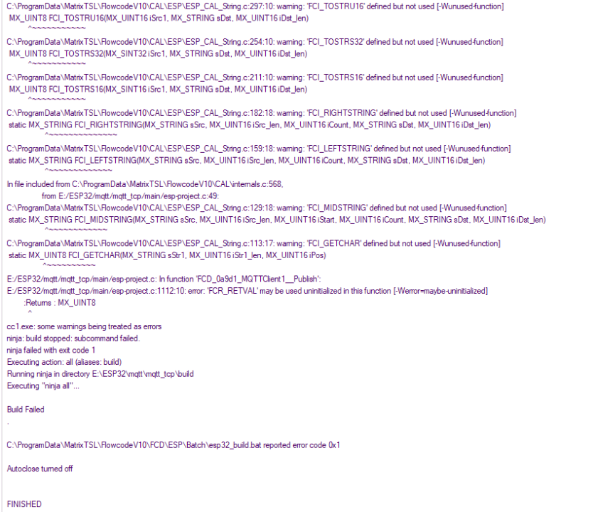

Hi Ben,
Today i just received update for mqtt client, and yes i see new Max Packet Size Variable has been added to the properties.
but when i do compile, there is just error, i also try this with example mqtt component and the error is arrise too. even i didn't change value for that variable.
Sandinug
Sandinug

Re: Change max character can send by mqtt Publish
Hi Ben,
Any update for this bugs ?
Thank you
Sandinug
Thank you
Sandinug
Sorry for the delay, hopefully resolved for you now.
