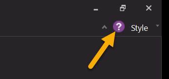

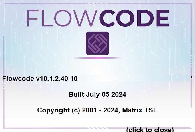

Hello. Where can I see my current version of the program? How can I edit the component code?
Posts: 1277
Has thanked: 245 times
Been thanked: 256 times
Re: Flowcode v10.1.2.40
Hi andrewproffi
You can click here :
a windows open then like this
