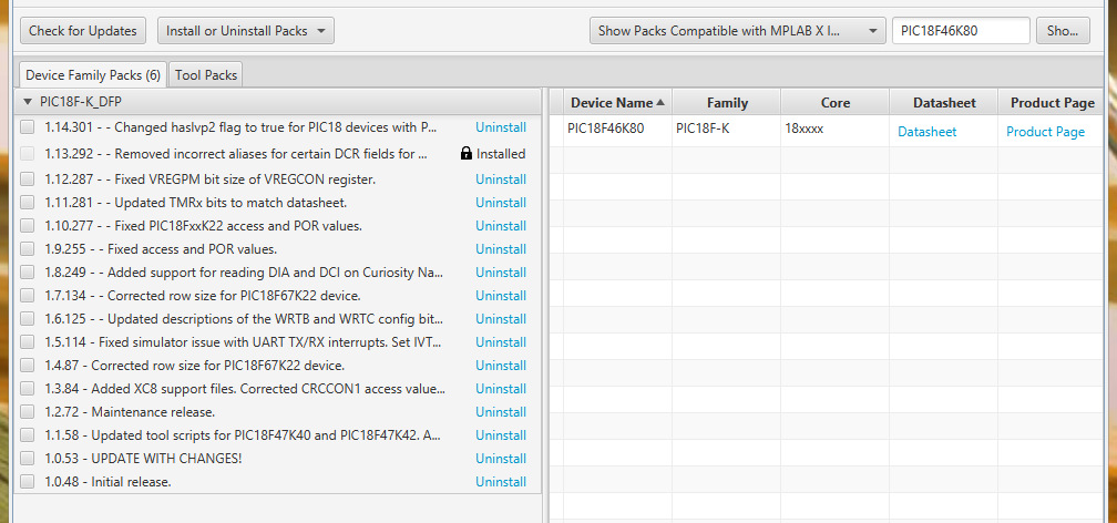

Hi Guys I'm having issues with compiling in V7 on my new PC when I try to compile i get the following error
C:\Program Files (x86)\Flowcode 7\tools\DoNothing\DoNothing.exe
Launching the programmer...
C:\Program Files\Microchip\MPLABX\v6.20\mplab_platform\mplab_ipe\pk3cmd.exe /P18F46K80/4"C:\Users\BRIANH~1\Dropbox\PCBOAR~1\GSMMOD~1\GSMU6A~1.1\Programs\GSM_U6_V1.6.1_10_07_24_46K80.hex" /M /OL
Unable to locate DFP, Please install required pack by using the Pack Manager in MPLAB X IDE
Could not find device:PIC18F46K80/4C:\USERS\BRIANH~1\DROPBOX\PCBOAR~1\GSMMOD~1\GSMU6A~1.1\PROGRAMS\GSM_U6_V1.6.1_10_07_24_46K80.HEX
Please install the required pack by using the Pack Manager in MPLABX IDE.
C:\Program Files\Microchip\MPLABX\v6.20\mplab_platform\mplab_ipe\pk3cmd.exe reported error code 36
I have been into mplab ide and and loaded what i think is right :?
MPLAB IDE.png (82.94 KiB) Viewed 5935 times

Posts: 1961
Has thanked: 292 times
Been thanked: 458 times
Re: Compiling error in V7
Can you please post the msg.txt files for both the v7 and v9 compilations. There may be clues in them as to why it works for v9 and not for v7.
There is some info about pk3cmd on the old v7 wiki here which may help:
https://www.flowcode.co.uk/wiki_old/wik ... ming_Tools
There's lots of info in that topic that is probably relevant.
