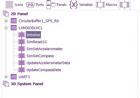

sorry to bother you but I ran into a few more bugs trying to make a compass:
1: LSM303D_Magnetometer1 component also don't compile,
2: EBM015 component also don't compile,
3: LSM303DLHC1 don't have Read_bearing, Read register and collectXYZdata but compile normally in this moment I can't confirm that component work.
thanks
thanks

Re: ESP32 and QMC5883 and HMC5883 not compiling
Please post your project so we can see where the problem is.
