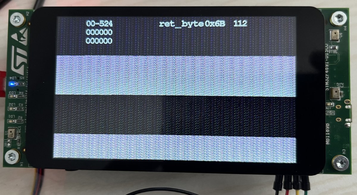

The display clock from the HSI bus is probably wrong, there is interference in the display.
If I change the clockspeed to 16Mhz, the interference is gone but I2C and Uart are then to slow.

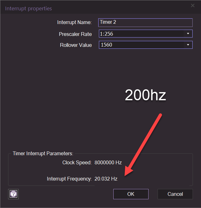

For a 200Hz interrupt choose 20Hz.....

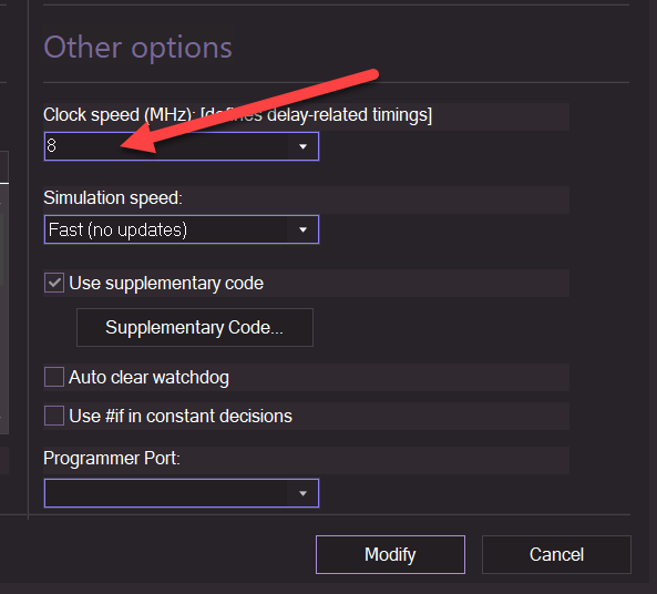

Looks like this Discovery board has an 8MHz crystal, so if you select HSE then the Flowcode settings clock speed needs to be set to 8MHz.
If you use the STM32F469NI internal source (HSI) then the setting needs to be 16MHz.

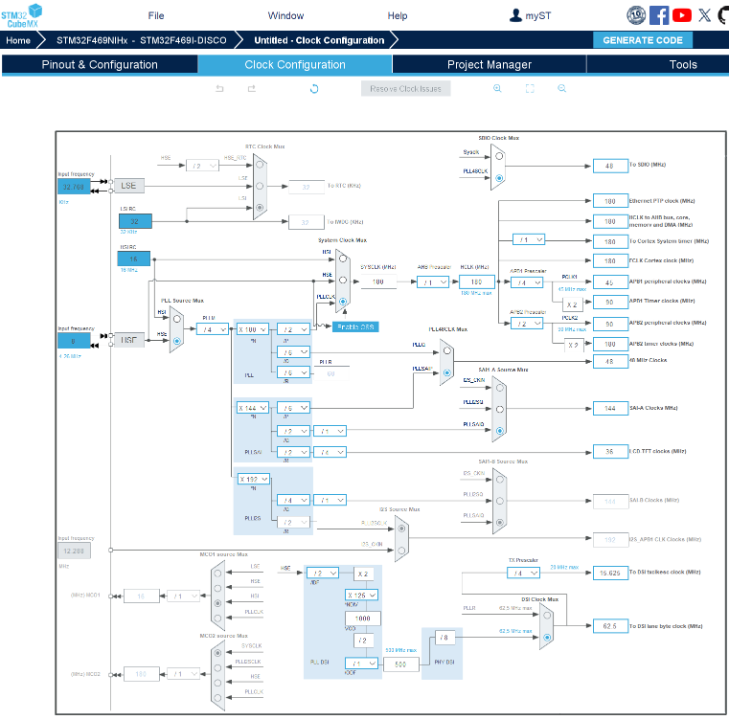

If you need to tinker with the internal clocks (and there are a few of them!) via the Flowcode Project Options, then you at least need to look at the STM32F469NI reference manual (RM0386)
or better still use the clock configurator of STM32CubeMX.

Regarding timer interrupts, that Flowcode dialog does not properly calculate timings for STM32 devices, as it isn't aware of the internal clock complexities. Prescaler and roll over values need to be determined manually, once you know the frequency of the internal APB2 timer clock.

If the IRQ is 10 times wrong it's OK. I can handle this.
I found the Clock conficurator but the Flowcode Project Options dont support all (or the required parameter)

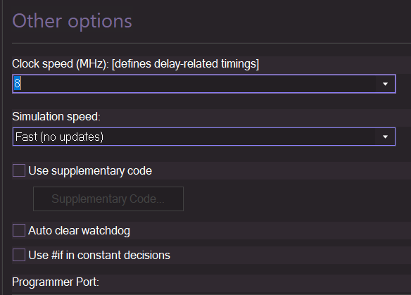

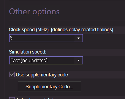

The error in the display occurs at startup if the "clock speed defines delay related timings" is set to 8 Mhz (8Mhz is correct).
and remains until I remove the power plug.
Even a new flashing with 16Mhz does not change anything. Once wrong, always wrong
But if I first load a program with 16Mhz and then flash programs with 8Mhz it is ok.
I suspect it goes wrong when I plug in the power plug and starting the Board.
The "reset on power" from the display, or the speed is too high during this time
But I have no possibility to change anything.

If I use 8Mhz both program generate a bad display
If I use 16Mhz both program are ok, but Uart and I2C clock are wrong
In my program I removed the IMU so you don't need to connect it
With this program I get the bad display. (tested on several board)
Sometimes the error only occurs when the board is restarted with my program. Resetting then does not help, it resets and restarts but the display is still bad. With a simple program the same problem
