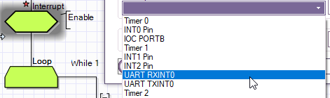

If I was you , I would use either UART RX interrupt Or use UART software timer as that also uses interrupts.
Either way you will no longer have any missed characters.
There is even a circular buffer available.
That will store the received chars until they are required.
For a great example on the best way download this flowchart.
as it also shows you how to set up the RX interrupt as well as circular buffer.
Let us know if you require further help.

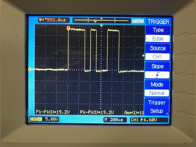

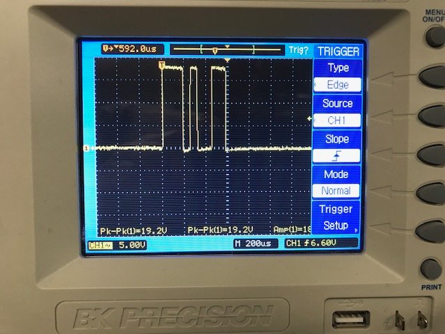

Following up... I managed to get the data transmit working OK in Flowcode V5, but not in V9. I suspect a bug unless there is something overlooked.
Two identical programs were written using V5 and V9 to transmit the Char 52 to turn on a relay. I could not load the V5 program here but have included the output data stream for both plus the code for V9.
Sending the Char 52 comes out correctly on V5, but not V9. The baud rate seems wrong. V5 is 920us, while V9 is 600us.
Both versions of Flowcode 'know' that the clock is 8MHz.
Any ideas what could be wrong here? Thank you both for your help on this.

Re: Serial receive using PIC18F4620 not working
For a baud rate of 9600, that would equate to a character being sent in approx 1mS so I would assume that v5 trace would be working. I haven't got one of those chips myself to check but I would look at configs. I know it is simplistic but an led flasher as suggested elsewhere is a good sanity check.
The IntOsc helper tool suggests for you to run at 8MHz the C-code should be OSCCON=0x70;
However you have OSCCON=0x7E;
I don't know the chip or have a datasheet to know if there are other bits that need setting within the register, but maybe try 0x70; to see how you get on?

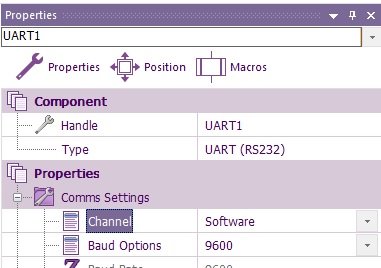

In your v9 program you are using the software UART. Can you try the hardware UART channel instead.
Software UARTs can be a pain to get bang on the nose whereas a hardware UART can easily do this.
If you need to use a software UART then can I suggest you instead use the UART Software (Timer) component. This uses a timer interrupt to allow you to get the timings just right.
