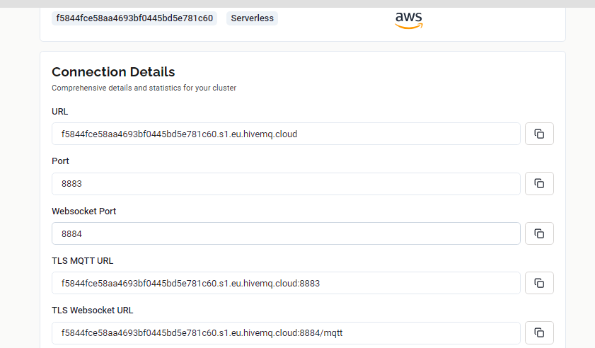

Hello. I'm trying to learn MQTT. I found answers to my questions in the topic below. Thank you. Based on what I've learned I can use a number value (then a sensor value) on thingboard, hivemq etc. I can't send.
viewtopic.php?t=2949
1- The file I made is attached. ESP32 connects to the internet. But I cannot send any data.
2- I opened both a demo and a free account on Thingboard and hivemq and applied all the settings. I tried to connect in both ways, using or not using a username, but I could not succeed.
4- Can you review the examples and help me where I am doing wrong?
5-I tried all the possible settings one by one for 2 days, but I could not get any results.
thingsboard, hivemq etc. using ESP32 or ESP8266 MQTT. I failed to send data. What am I doing wrong?
- hivemq.PNG (47.97 KiB) Viewed 12420 times
