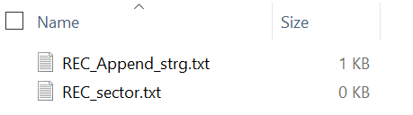

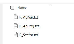

I still have problems with writing the sector.
The file remains empty.

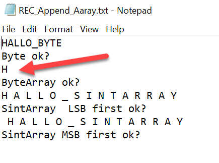

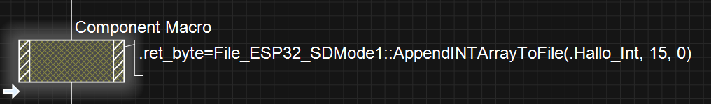

- local array append give problems to compile, you can see when you activate them in the macro, but with global array it compiles.

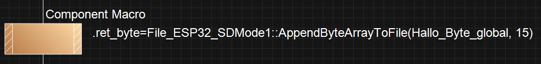

- AppendByteArray is appending just one letter

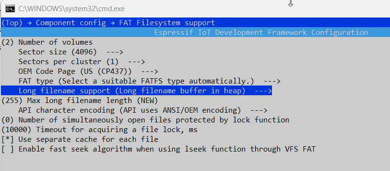

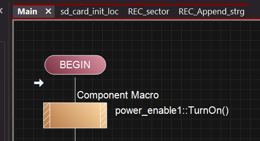

There is still a small problem. I use the option long filename support. This option must also be selected in the menu. If this is not done, my test will not work for you. I have changed the longname to a short in the test program.
program with shortname:
Test_SD_post_ShortName.fcfx
(50.38 KiB) Downloaded 352 times
with shortname:
program with longname need a change in menue:

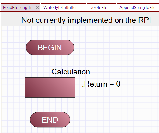

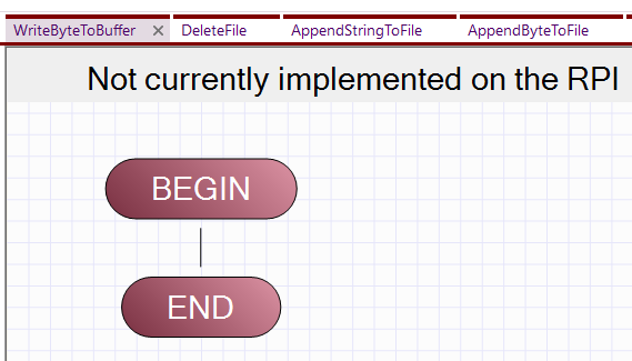

I have looked at the component and WriteByteToBuffer, ReadFileLength do not work and are perhaps not yet implemented,
or I still don't understand exactly how it works.

from component WriteByteToBuffer:
from component ReadFileLength:
