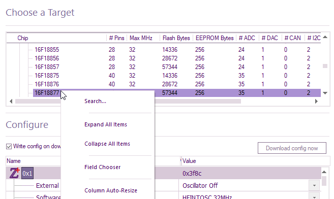

1) Search for a target device.
When in the project options, right-click on any target.
That will bring up:
Search for target.png (28.69 KiB) Viewed 19740 times
Since there are loads of microcontrollers you can choose from all you need to do is select the search and enter a few numbers of the required device.
for example, I'm interested in using the PIC12F1840, so I just enter 1840, then select find next.
No matter what device you currently have selected, it will highlight any device that has 1840.
If the highlighted device is the one you are interested in, then just click on the x of the find box, and select modify (bottom right of project options window.

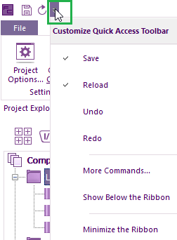

To do that select Customize Quick Access Tool bar:

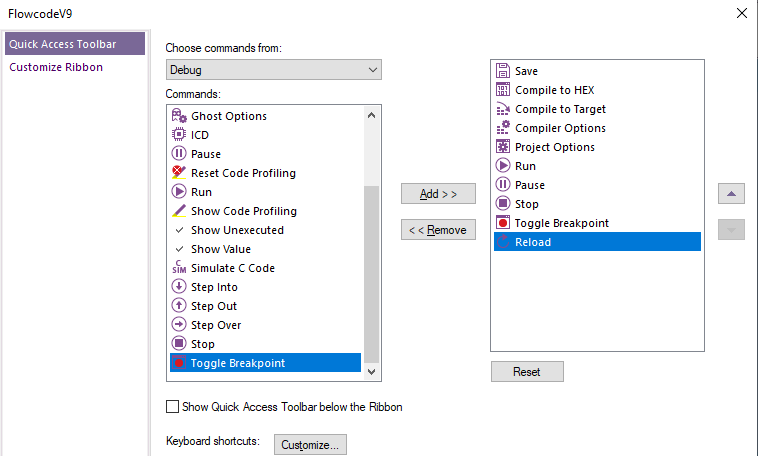

Select More Commands, then just go to drop-down menu that you are interested in.
E.g for Compile to Target change drop-down from Edit to Build.
Select Compile to Targetthen click on the Add>>.
If you have selected these:
Customize Quick Access Tool Bar2.png (35.95 KiB) Viewed 19740 times
Then you will see:
Customize Quick Access Tool Bar3.png (2.18 KiB) Viewed 19740 times

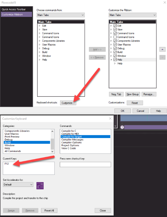

For me, the hot keys in FC9 are very useful. I used F11 for save and F12 for compile to target
Customize ribbon_Build_F12.png (90.84 KiB) Viewed 19679 times
