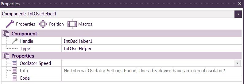

First thing I noticed was that you are running on an internal oscillator but forgotten the C-Code block to set. FC has a handy tool to calculate the code for you found under Component Libraries > Runtime > IntOsc Helper.
However this claims that there is no internal oscillator for that chip which appears to contradict the datasheet that states a 4MHz one is available.

I haven't used any, but thought that a C-block would be necessary to set the configuration. However in my post above it looks like there is some issue with the component configuration. Incidentally I forgot to mention that I too get the same error using v11.
Guess it's one for the team?
