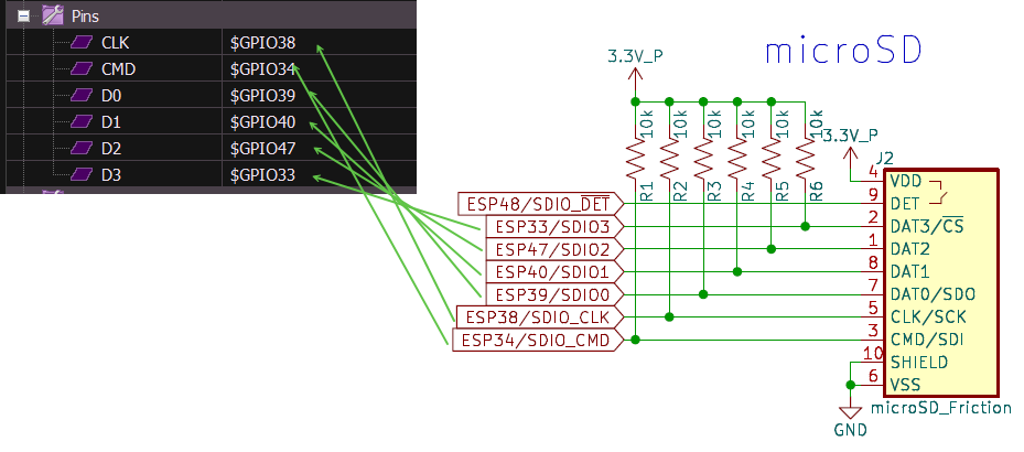

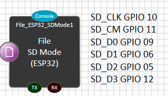

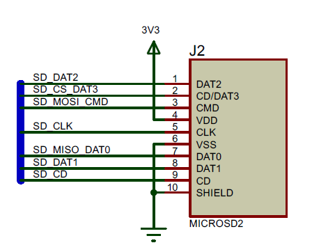

I tried a different board—this time from SparkFun—and the card initialization caused problems there as well.
I checked the pins and they should be okay.
I think it's just a startup issue in my program?

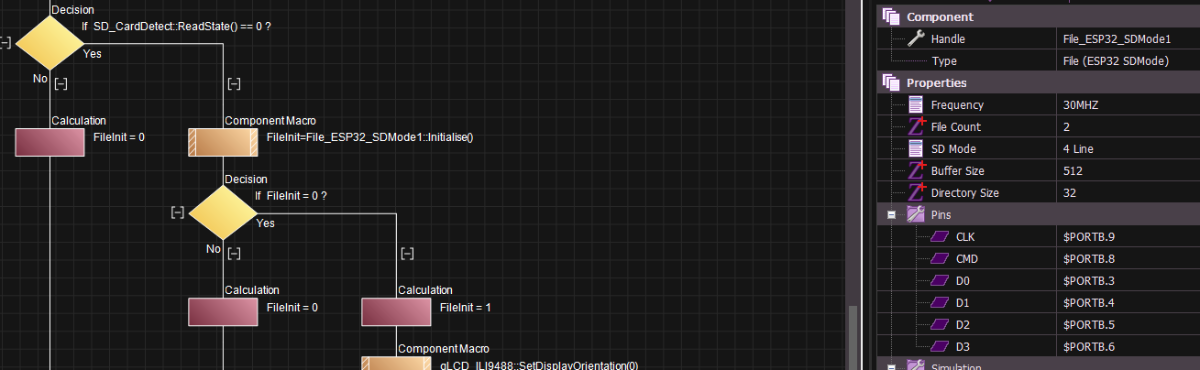

Hello Stefan,
As I say we have it working great on the ESP32S3 so not sure wehat the problem is here.
This is my firmware project file and the part that initialises the card. We are sure the card is running as we put bitmaps and font data onto the card and that's all working great.

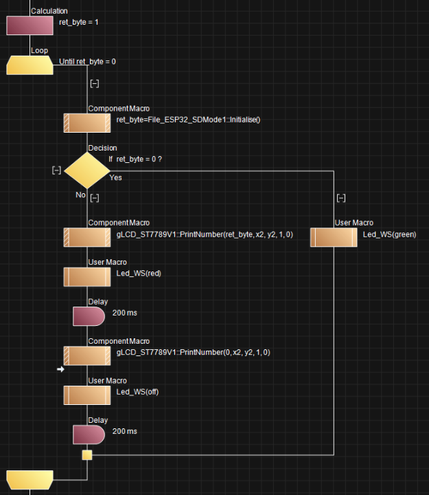

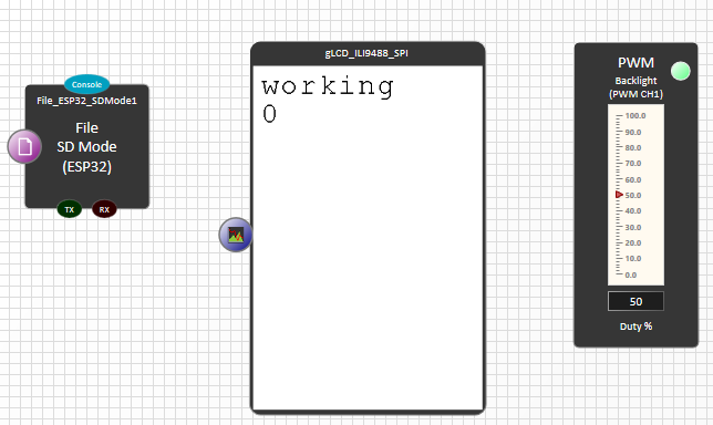

I created a small test program.
It works in the simulation, but in hardware it never exits the loop.
