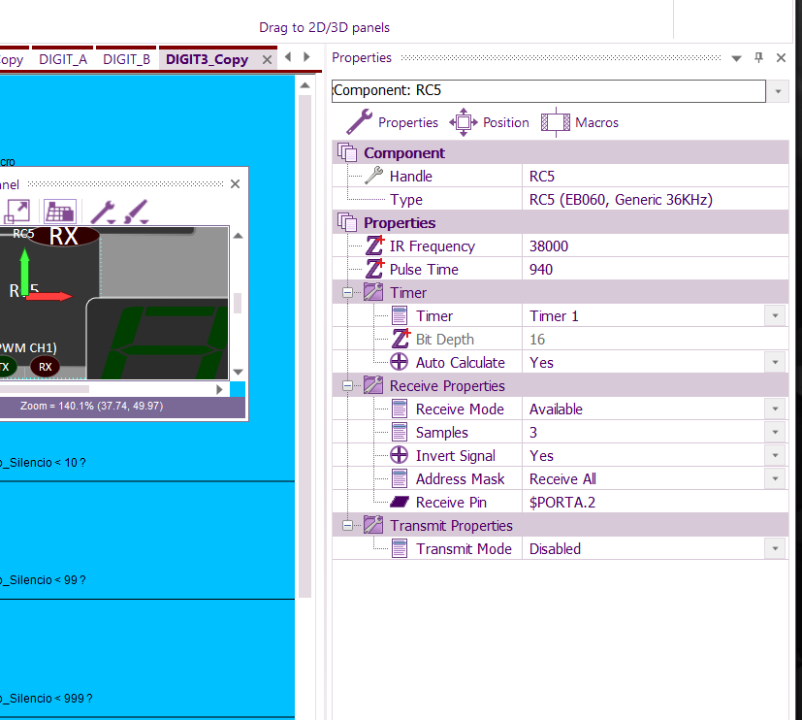

Por lo visto las propiedades del componente han cambiado del 2020 a 2026, si se puede cambiar las propiedades, pero si funcionara para comprar unas cuantos modulos :?:
Enrique

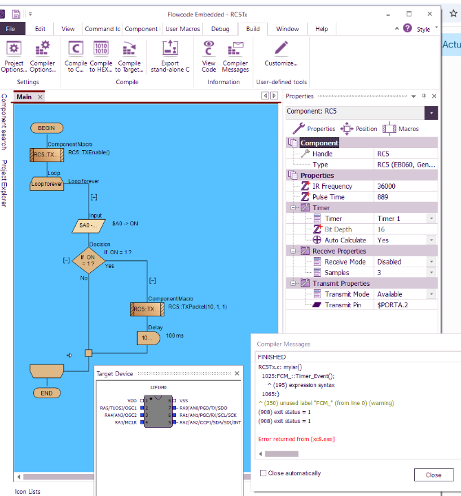

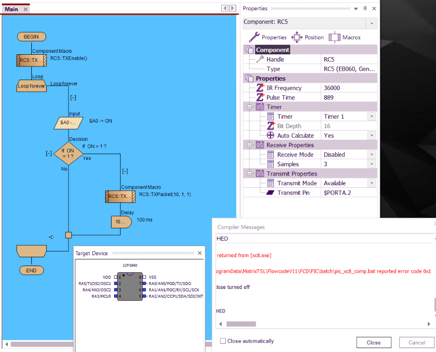

I started programming TX for now, but when I compile it, I get an error. It shows the same thing in Flowcode 10 and Flowcode 11.
I selected the three timers (Timer0, Timer1, and Timer2) in the properties, and I didn't change the original frequency or pulse time.
I think it's a bug.
Enrique

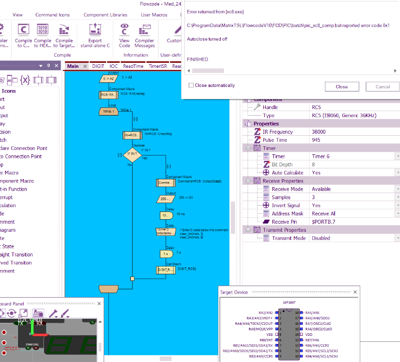

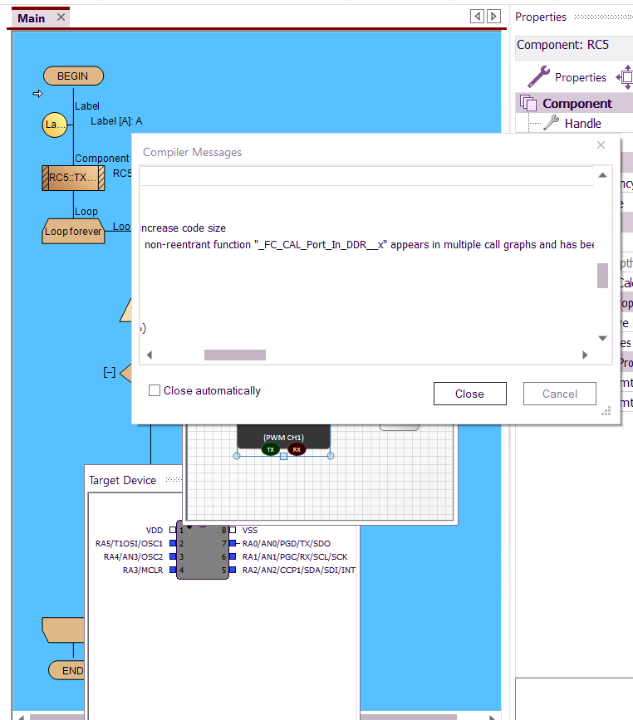

I apologize, it might seem like I'm just playing around, but I'm not. I took the published example and made some changes, and it compiles correctly, with two warnings, but it finishes compiling. Now, in a program I've put together, I added the RC5 component, and it again shows an error when compiling. This is the message it displays. Could you check it to see if it's a bug in Flowcode 10 or if I've made a mistake :?:
Enrique

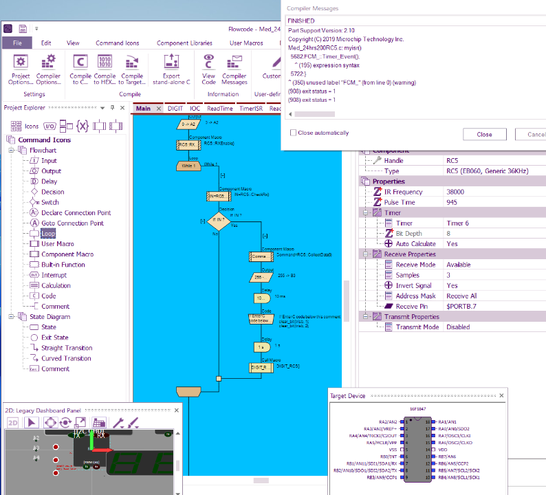

This is the rest of the compilation error.
