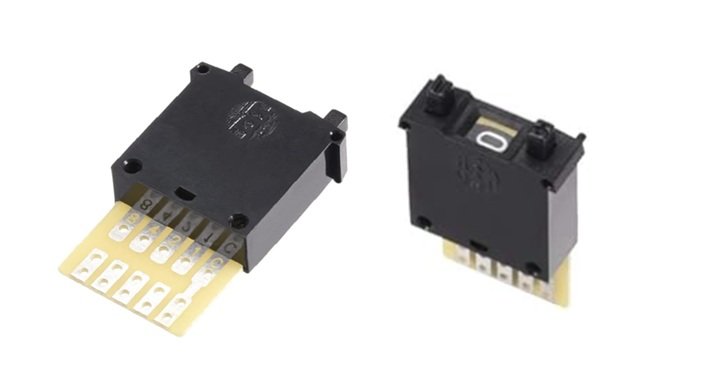

It looks like this component is made for a BCD (Binary-Coded Decimal) thumbwheel switch (as shown in the attached picture), rather than a standard rotary switch with a common pin and individual position connections.
Unlike a standard selector switch, this unit outputs a 4-bit binary code (pins 1, 2, 4, and 8) corresponding to the selected digit (0–15).
