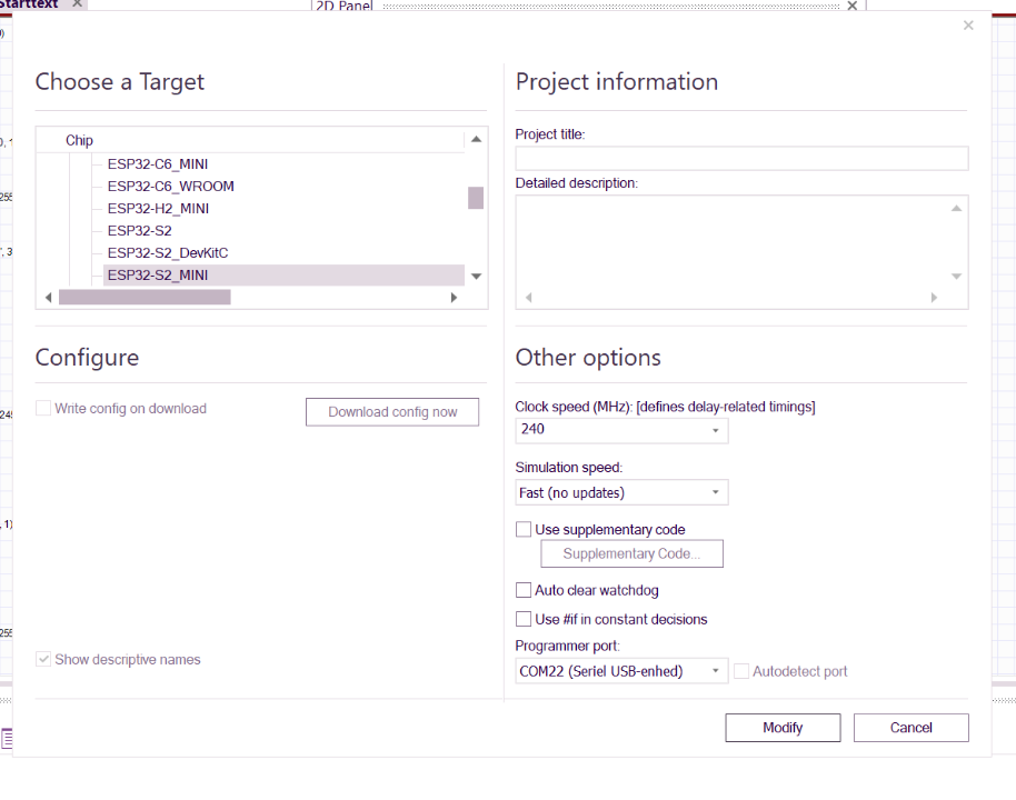

I have just tryet to compile a program to ESP32 S2. I ger error1. As far I see it is something with the port. I see the programmerport in Project option and in devicemanager, but the Autodetect is Ghosted, again what am I do wrong, please.

Re: Esp32_2_Mini compiler port fail
A fatal error occurred: Could not open COM_AUTODETECT, the port is busy or doesn't exist.
(could not open port 'COM_AUTODETECT':
Try removing the auto detect and setting the port manually?

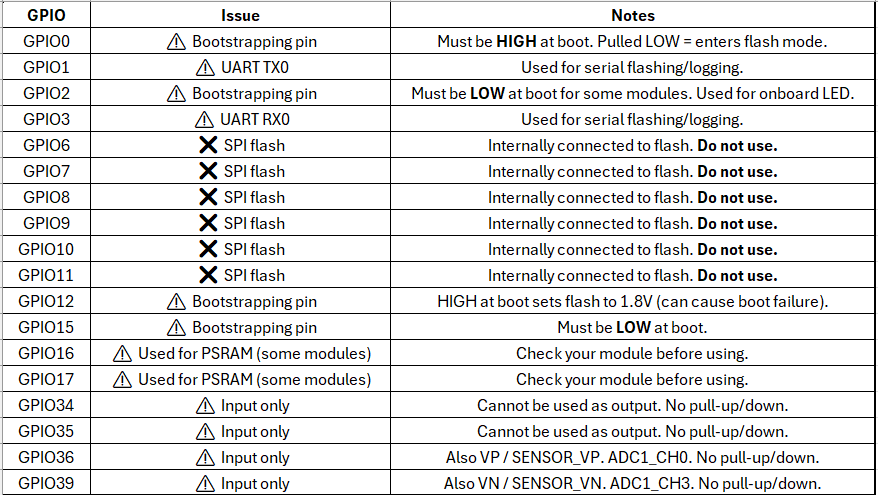

Hi Jorgen
Measure the voltage on GPIO0.
Even though it can be used for IO, don't load it as if IO0 is less then 0.8V it will be forced into download mode, which could be the error you are seeing.
What is the voltage of IO0?

Hi Martin,
My ESP32-S2 Mini board doesn't actually have a GPIO0 pin broken out on the pin headers—GPIO0 is only connected to the onboard BOOT button. Nothing external is connected to it, so it should remain pulled high during normal startup.
