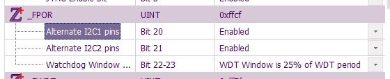

Re: MCP23017
I beleive it could be these configuration settings at fault, they probably should be set to disabled to match your I2C pin selection.

Hi Ben,
Yes that was the issue, I am now reading port pins without issue.
