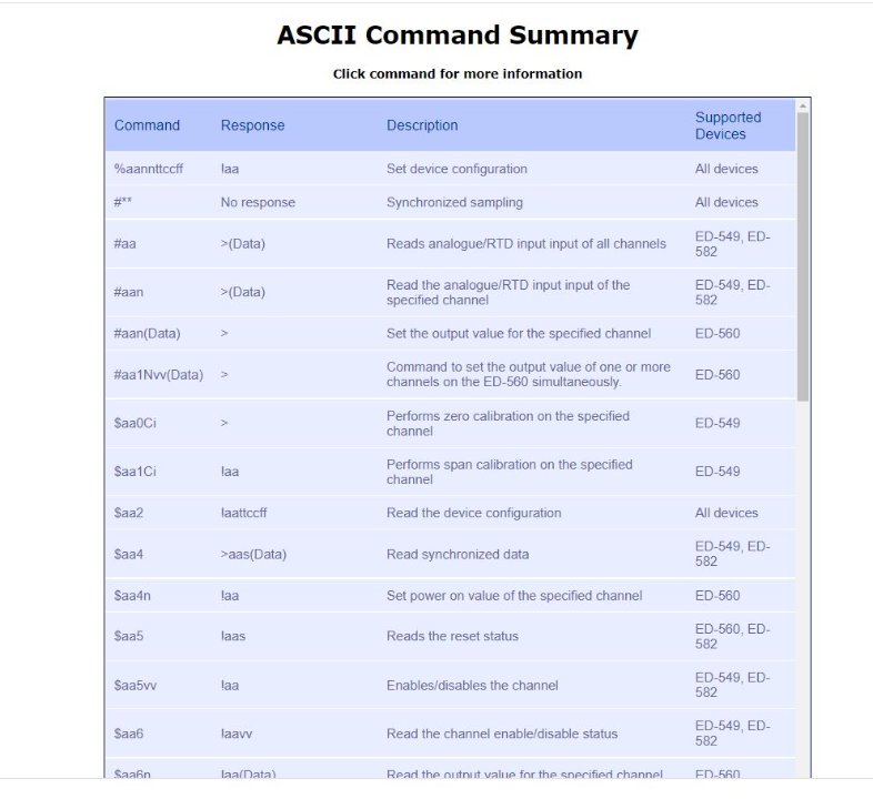

Afternoon All,
Dose the Ethernet module support ASCII Protocol commands ? commonly used it Automated Test Equipment
2 examples of commands attched
Steve
IP Comminucation Protocol.pdf

I believe it does, in that it can send and receive text. You will need to form the required strings in your code, send them and then wait for and read the expected response.

.. and it looks like it uses UDP (not TCP/IP)

I will have a go later - are there any examples anywhere ?
Steve

There are examples in the wiki, depending on what component you are using. Also, there's a free course entitled "Embedded Internet" in the "Education" section of the flowcode.co.uk site that might be of help.
