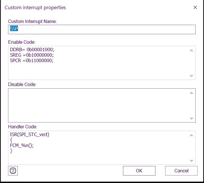

I use ATMEGA 128 controller.
When using interrupts and the SPI Slave macro compiler gives an error.
TEST.c:(.text.FCM_SSP+0x0): undefined reference to `FC_CAL_SPI_Slave_RxByte_1'

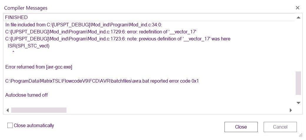

Again, error, but in another project with ATMEGA 128
Interrupts do not work ....

Before using the Flowcode macros, the С code was written,
But after the use of macros Flowcode, the compiler began to issue an error!
As a result, neither macros do not work С code !!!
SPI.fcfx
(14.48 KiB) Downloaded 646 times

The compiler is complaining that you have got the same interrupts enabled in Main and COXPAH.
If you remove one it should compile for you.

Right!!!
Thanks a lot!!!
