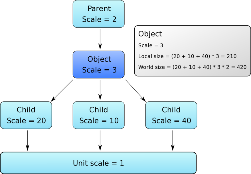

Bounding box
The bounding box of the object is exactly the same as its position, except that instead of a scale a size is used instead. This is the scale of the object multiplied by the size of all the child objects.
The size of a leaf object is equal to its scale, as the object has no children to multiply its scale by. Hence the bounding box of a leaf object is the same as its local position.
