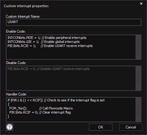

USART Receive
The Flowcode RS232 component can be used to set the Baud rate and configure the mode of operation, and the ReceiveRS232Char function can be used in the handler macro to read the data (clearing the interrupt).
Enable code:
INTCONbits.PEIE = 1; // Enable peripheral interrupts
INTCONbits.GIE = 1; // Enable global interrupts
PIE1bits.RCIE = 1; // Enable USART receive interrupts
Disable code:
PIE1bits.RCIE = 0; // Disable USART receive interrupts
Handler code:
if (PIR1 & (1 << RCIF)) // Check to see if the interrupt flag is set
FCM_%n(); // Call Flowcode Macro
PIR1bits.RCIF = 0; // Clear interrupt flag

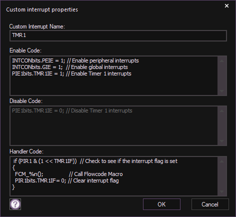

Timer1 Rollover
Enable code:
T1CON = 0x79; // Start timer with Internal clock source, prescaler = 1:8
PIE1bits.TMR1IE = 1; // Enable Timer 1 interrupts
Disable code:
PIE1bits.TMR1IE = 0; // Disable Timer 1 interrupts
Handler code:
if (PIR1 & (1 << TMR1IF)) // Check to see if the interrupt flag is set
PIR1bits.TMR1IF= 0; // Clear interrupt flag
The captured 16-bit count value can be read into a Flowcode variable 'captval' with the following C code line:
FCV_CAPTVAL = TMR1L | ( TMR1H << 8 );
