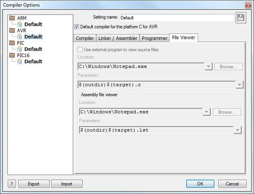

Note: The above parameters assume you are using the AVRDUDE programming application and AVRISPmkII programmer. If you are using an alternative programming application or programmer you will need to consult the relevant documentation for the required parameters and settings.
File Viewer
File Viewer location
Sets the File viewer location for viewing C and Assembly files.
Default:
C:\Windows\Notepad.exe
File Viewer parameters
Adds command line parameters for the File viewer program
Default Assembly file viewer:
$(outdir)$(target).lst
Default external program to view source files:
$(outdir)$(target).c
