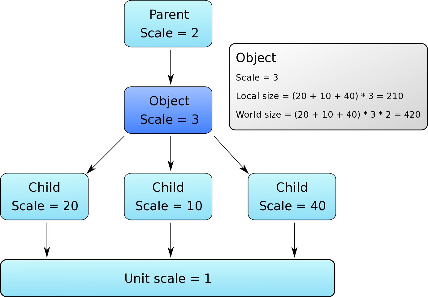

[[File:Eg Scale Tree.svg|right|thumb|Scaling hierarchy]]
[[File:Eg Scale Tree.svg|Scaling hierarchy]]
The bounding box of the object is exactly the same as its position, except that instead of a ''scale'' a '''size''' is used instead. This is the scale of the object multiplied by the size of all the child objects.

Bounding box
Scaling hierarchy The bounding box of the object is exactly the same as its position, except that instead of a scale a size is used instead. This is the scale of the object multiplied by the size of all the child objects.
The size of a leaf object is equal to its scale, as the object has no children to multiply its scale by. Hence the bounding box of a leaf object is the same as its local position.
