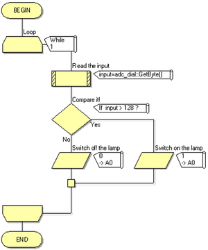

The flowchart sequence
The flowchart will:
- Read the value set on the input device, the ADC dial.
- Compare this with a set value, and:
- if greater than the set value, turn on a lamp;
- if less, then make sure that the lamp is off.
- Loop back to the beginning, and repeat the process.

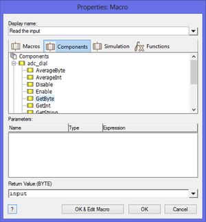

- Inside the loop:
- Double click on it to open the dialogue box, so that you can configure it.
- The program 'knows' which components you have added to the System or Dashboard panel, and modifies the list of available commands accordingly.
- Under 'Components', the ADC dial will be listed, and underneath it the list of commands.
- Scroll down the list and click on the 'GetByte' command.
- This reads the output of the analogue input device - the ADC dial in this case, and stores it in the byte variable called 'input'.
- Rename the 'Display name' as "Read the input".
- Click on 'OK'.
- Again, the dialogue box is shown opposite.

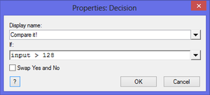

- Rename it "Compare it !"
- In the condition 'If' box, type "input>128".
- The '128' is totally arbitrary in this program. A byte variable can store any value from 0 to 255, so 128 is roughly half way.
- In this case, the program decides whether the value stored in the variable 'input' is greater or smaller than 128, and reacts differently depending on that decision.
- Click on 'OK'.

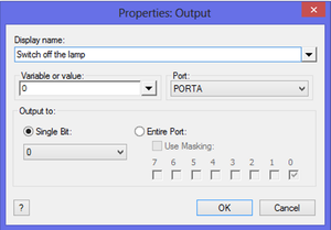

- In the 'No' branch, drag and drop a second 'Output' icon.
- Double click on it to open the dialogue box.
- Change the 'Display name:' to "Switch off the lamp".
- In the 'Variable or value:' box, type "0".
- Configure the rest of the box to output this to 'PORT A' 'Single Bit:' 0.
- Click on 'OK'.
- Again, the dialogue boxes for the 'Output' icons are shown opposite.
The flowchart should now resemble the one shown below.

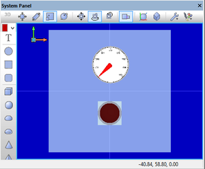

Add the LED
- Locate an LED such as the LED 5mm Panel in the 'Outputs' toolbox in the Icons toolbar.
- Hover over the image to the left of the component label 'LED 5mm Panel', and click on the down-arrow that appears.
- Click on the 'Add to system panel' option to select it.
- Select the LED on the System panel and drag it to a suitable position.
- Look at the Panel Properties, the 'Connection' property make sure that it is connected to Port A, bit 0 ($PORTA.0).
- Leave it like this.
Add the ADC dial
The ADC dial represents a number of input devices.
- Locate the 'ADC dial' in the 'Inputs' toolbox in the Icons toolbar.
- Hover over the image to the left of the label, and click on the down-arrow that appears.
- Select the ADC dial on the System panel and drag it to a suitable position.
- Look at the Panel Properties, and locate the 'Connection' property. Just below it, the 'Channel' property shows that, by default, it is connected to 'AN0' - the first bit of the microcontroller capable of accepting an analogue input. Click on 'AN0' to open a pinout of the microcontroller.
- Click on the rectangle representing input 'AN1' to change the connection to this channel.
The System Panel should resemble the image shown at the top of the page.
