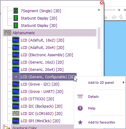

Next add the component you wish to customise to your favourite panel. I am using the LCD which I want to assign with custom pre-set pins on PortD.

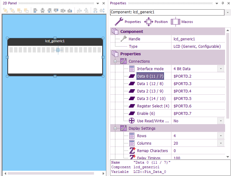

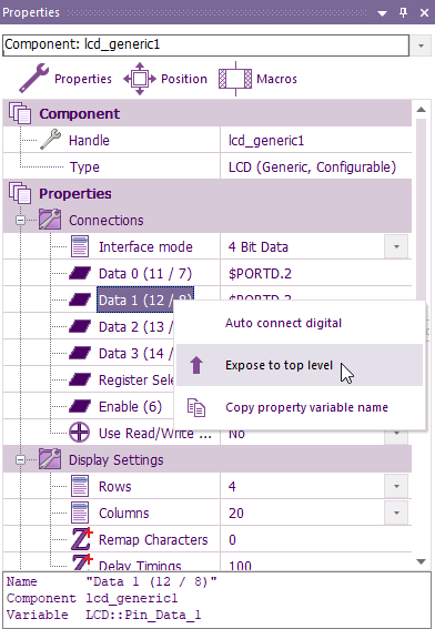

Select the component on the panel and open the Properties window. Then adjust the properties to be as you want them to be. For example I'm going to change the pins from the default PortB 0-5 to PortD 2 - 7.
Exposing Properties

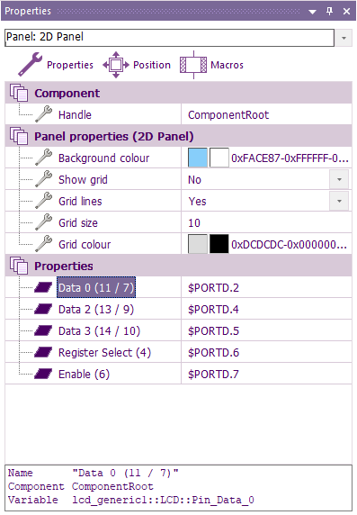

While we are in the properties window there may be properties that you will still need to be available to the user when using your new customised component. Simply right click these properties and choose Expose from the menu to expose these properties to the user of the component.
You can see which properties will be available to the user by clicking on a blank area of the component panel, or by choosing Panel from the drop down menu at the top of the Properties window.

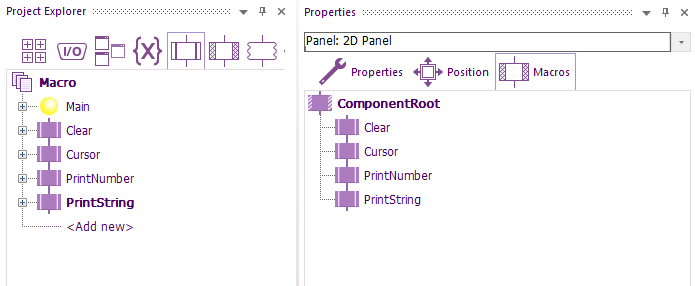

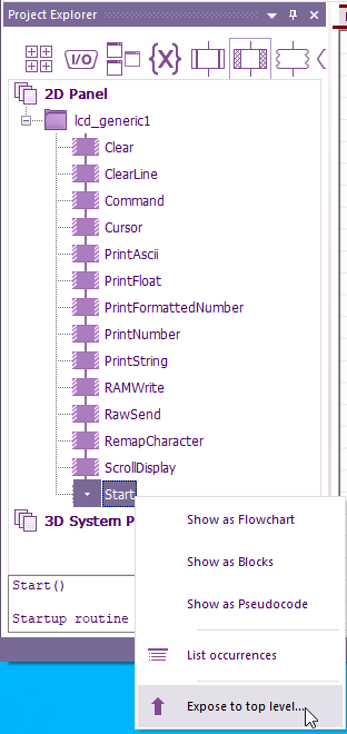

As well as properties you will also need to expose the macros for the component that can be called. This could be all the components macros or could simply be a sub set if you only ever use a few macro calls from a component. Open the Project Explorer window and select the components tab, then right click any macros you want available and select Expose from the menu.
You can see which macros will be available to the user by clicking on a blank area of the component panel, or by choosing Panel from the drop down menu at the top of the Properties window and then selecting the Macros tab.

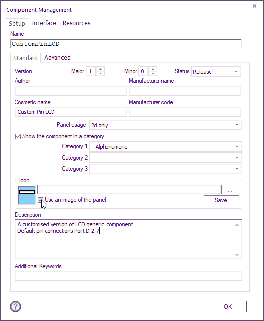

Next click on the File -> Component Configuration menu.
Setup Tab - Standard
Give the component a Name, a Cosmetic Name, Assign a Category from the drop down menu.
Setup Tab - Advanced
If you have already created one component from your project file and want to create a new but different component then click Edit next to GUID and click New next to the GUID, this ensures you do not overwrite your previously exported component.
When you're done click OK.
